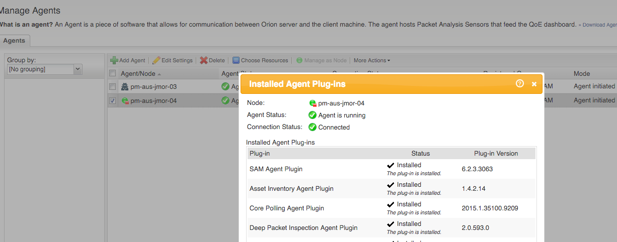

Ahh, ok this is an agent. Sorry I missed that. Is the node managed via the agent or is the node managed in Orion using SNMP or WMI? You can view the list of agent plugins installed on the agent by going to [Settings -> Manage Agents] then select the agent and click [More Actions] from the top menu and clicking [view] as shown below. You should see a "SAM Agent Plugin" listed if the node is managed via the Agent in Orion. If it isn't, click the "Manage as Node" button from the same top menu.
