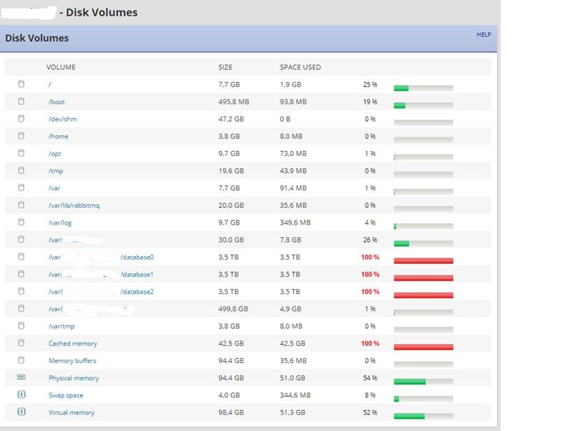

I've monitoring a Linux server (CentOS) to trigger an alert if a partition is filled up but I'm havig issues to get the correct disk sizes (see the images attached)

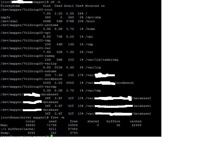

As you can see according the previous screenshot the database0,database1,database2 are at 100% and reporting a máximum partition size of 3.5TB but if you check directly on the server you see the following:
The correct size for database0,database1,database2 is 32TB, those mounted points are on a disk array enclosure connected directly to the server via a SAS cable, is there any way to get the correct sizes? is there any known limitation to monitor something like this?
