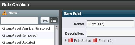

Hey nicole,
Thanks for the info.
This is what I want to do. I need to monitor failed scheduled task in Microsoft-Windows-TaskScheduler/Operational log in 2 server .
For every error event found- 101, 311 and 202 and email alert will send.
I just accomplished this using SW log event forwarder and SW syslog but I want to try it using LEM.
I can't figure out where to start in rule creation.
