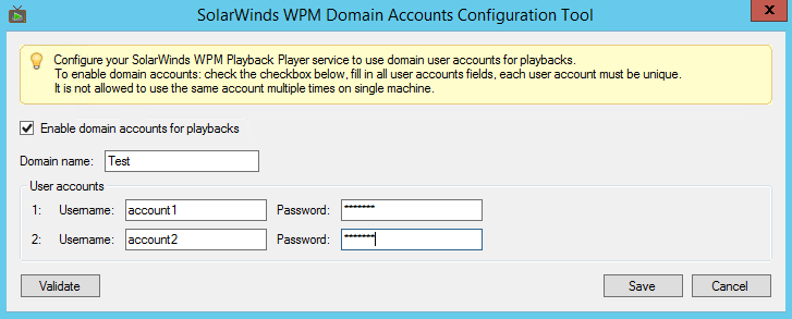

WPM Player Setup: Assign the Account Credentials to access the Certificate
Note:
- Recommended
- This may vary for each player depending on the environment.
- This is required because each worker process handles different transactions at different times.
- Less Users means less possible transactions that could be played simultaneously.
- Only Domain Accounts are supported in this Tool.
- If tool fails, see Manually Adding Domain Accounts to WPM Player
- All passwords are automatically encrypted after the agent service is started. With XML, you cannot use an illegal character in the username and password fields, such as the following three: &, ', "
- Navigate to the SolarWinds install director (C:\Program Files (x86)\SolarWinds\Orion\SEUM\Player)
- Launch SolarWinds.SEUM.AgentDomainConfigurationTool.exe.
- Check the box next to 'Enable domain accounts for playbacks'
- Fill in the Domain name, Username, and Password for each account in the fields as seen below:
- You must use the Accounts you created certificates for an installed the certificates for those accounts on the system you are running this tool.
- Click Validate, and then save.
- Restart the WPM Playback services

- Error "Number of available domain accounts is lower than maximal number of worker processes."
- Navigate to the SolarWinds.SEUM.Agent.Service.exe.config file located in the install location of the SEUM player C:\ProgramFiles(x86)\SolarWinds|Orion\SEUM\Player.
- Look for numWorkerProcesses
- Number of given accounts must be higher or equal to the number of worker processes
- Save, file. Restart Services.

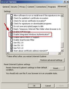

- Players are having problem authenticating automatically.
If WPM Players are having authentication problems when playing back recordings, check whether the recorded web site uses Windows authentication for its login process. Some computer systems are set up to pass-through Windows credentials without prompting for a username and password, and if you create a recording on such a computer, the username and password required for the web site will not be saved with the recording. This may result in an authentication problem when the recording is played back on a different computer.
To ensure that the Recorder always automatically authenticates with the logged in (*&(*& username and password for web sites protected by Windows authentication:
- Run the recorder under a local user account instead of a domain account.
- Select Enable Integrated Windows Authentication on the Advanced tab of IE Internet Options settings, you may also need to scroll to the bottom and also select . This option requires a restart of Internet Explorer.
