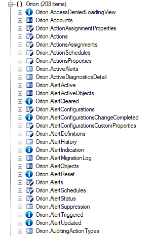

I knew that I had to start with the alert, so I opened SWQL Studio (part of the Orion SDK) and starting crawling around the Orion.Alert tables.

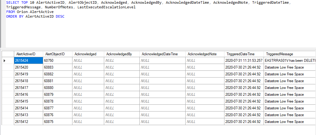

After looking through a few of them, I ended up on Orion.AlertActive. This looks to be a list of all the current active alerts as opposed to Orion.AlertHistory, which appears to be historical.
 | SELECT TOP 10 AlertActiveID , AlertObjectID , Acknowledged , AcknowledgedBy , AcknowledgedDateTime , AcknowledgedNote , TriggeredDateTime , TriggeredMessage , NumberOfNotes , LastExecutedEscalationLevel FROM Orion.AlertActive ORDER BY AlertActiveID DESC |

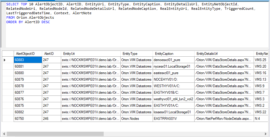

Since alerts are triggered on a specific object that is being monitored, I needed to get that information as well. I've got some details of the alert in general, but I still need the triggered alert.
After querying a few tables, I found what I wanted in the Orion.AlertObjects table.
 | SELECT TOP 10 AlertObjectID , AlertID , EntityUri , EntityType , EntityCaption , EntityDetailsUrl , EntityNetObjectId , RelatedNodeUri , RelatedNodeId , RelatedNodeDetailsUrl , RelatedNodeCaption , RealEntityUri , RealEntityType , TriggeredCount , LastTriggeredDateTime , Context , AlertNote FROM Orion.AlertObjects ORDER BY AlertID DESC |
Both tables have an AlertObjectID, so I knew I could join the two together. I also saw that the Orion.AlertObjects table has the field EntityNetObjectId, which contains a way that we uniquely identify monitored elements in Orion, so I took note.

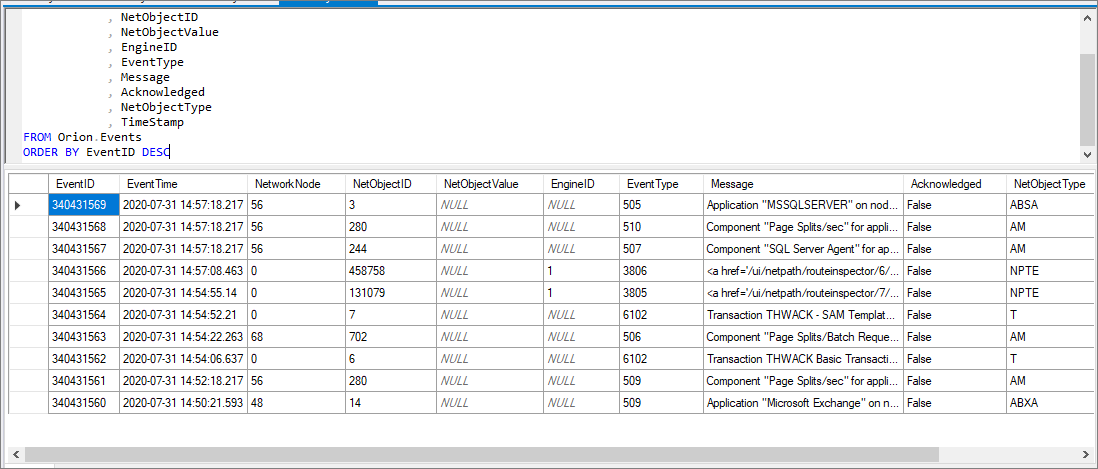

Last, but not least I needed to look at the Orion.Events table.
 | SELECT TOP 10 EventID , EventTime , NetworkNode , NetObjectID , NetObjectValue , EngineID , EventType , Message , Acknowledged , NetObjectType , TimeStamp FROM Orion.Events ORDER BY EventID DESC |

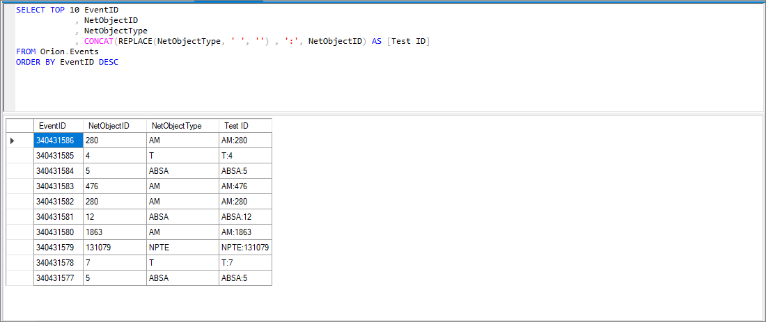

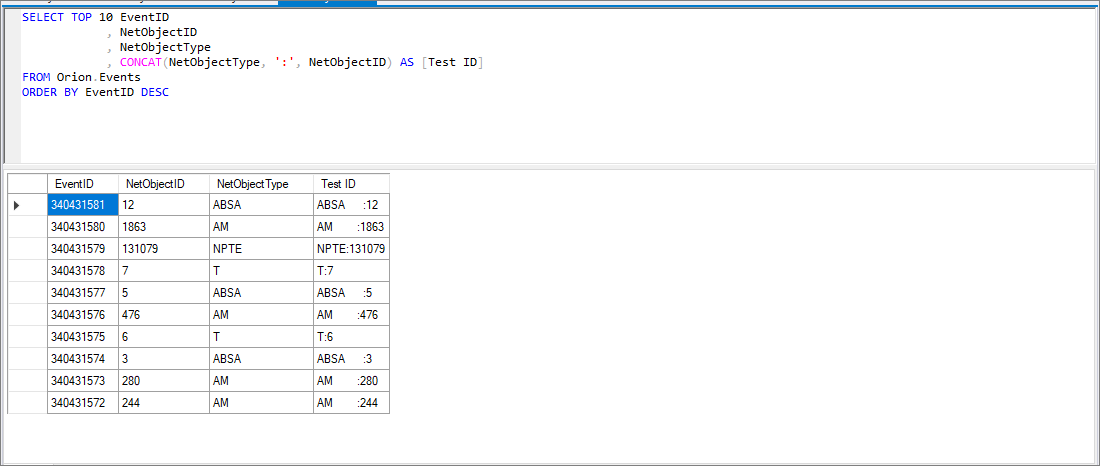

In the Orion.Events table I could see the NetObjectType and the NetObjectID. If I put a colon between these two entries, it looks just like the EntityNetObjectId from the Orion.AlertObjects table. So, let's add that to the output using the CONCAT function and remove the stuff from the SWQL query I don't need. [Note: The CONCAT function just joins the elements provided by the parameters into one long string. You can do a similar thing with the '+' operator, but I prefer the function.]
 | SELECT TOP 10 EventID , NetObjectID , NetObjectType , CONCAT(NetObjectType, ':', NetObjectID) AS [Test ID] FROM Orion.Events ORDER BY EventID DESC |
Well, that doesn't exactly look right. It looks like the NetObjectType field is padded with spaces. If they are spaces, then we should be able to replace them with nothing and get the result we want. So, I tried again to see if my hunch was correct using the REPLACE function.
 | SELECT TOP 10 EventID , NetObjectID , NetObjectType , CONCAT(REPLACE(NetObjectType, ' ', '') , ':', NetObjectID) AS [Test ID] FROM Orion.Events ORDER BY EventID DESC |

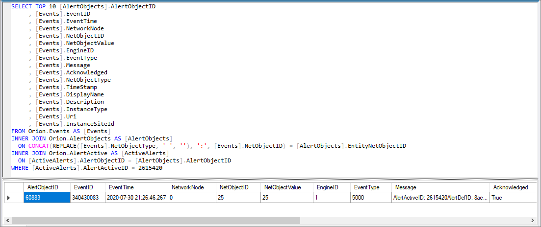

Much better. Then it was just a matter of stringing my three tables together using some JOINs. For the example below, I chose an arbitrary AlertObjectID to use for testing.
SELECT TOP 10 [AlertObjects].AlertObjectID , [Events].EventID , [Events].EventTime , [Events].NetworkNode , [Events].NetObjectID , [Events].NetObjectValue , [Events].EngineID , [Events].EventType , [Events].Message , [Events].Acknowledged , [Events].NetObjectType , [Events].TimeStamp , [Events].DisplayName , [Events].Description , [Events].InstanceType , [Events].Uri , [Events].InstanceSiteId FROM Orion.Events AS [Events] INNER JOIN Orion.AlertObjects AS [AlertObjects] ON CONCAT(REPLACE([Events].NetObjectType, ' ', ''), ':', [Events].NetObjectID) = [AlertObjects].EntityNetObjectID INNER JOIN Orion.AlertActive AS [ActiveAlerts] ON [ActiveAlerts].AlertObjectID = [AlertObjects].AlertObjectID WHERE [ActiveAlerts].AlertActiveID = 2615420 |

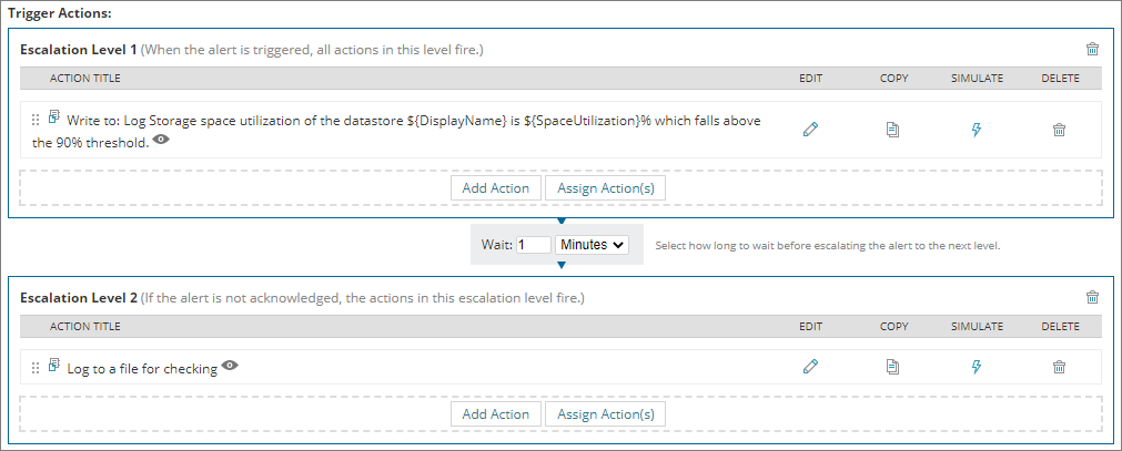

For my example, I duplicated the Datastore Low Free Space alert and called it Datastore Low Free Space (with Event) becuase I am not creative.

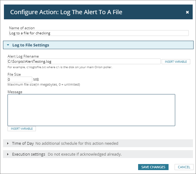

I kept the original trigger action in place (Write to the NetPerfMon Event Log) and then created an escalation layer. I created the escalation layer because I wanted to be 100% sure that the Orion.Events table would have the record when I went to query it. I probably could have done this any time after the initial log write, but I'm being overly cautious.
For that second layer, you can use any type of action, because the important part is when you get to edit the message that's used. In my example I used a log to a file because it was easy to test.
When you edit the message body (for an email, raising a ticket/incident, writing to a log file, sending a syslog/trap, or whatever else), you'll need to insert a custom variable.
When you are in the body, click Insert Variable, check the box for Define SQL/SWQL Variable (Advanced), and move the radio button over to SWQL.

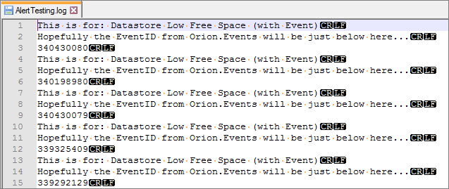

And I know that this works because after I saved my new alert, this is what showed up in that flat log file:
There's also at least one caveat: if you have multiple messages being logged for a single alert, you may need to use TOP 1 and an ORDER BY clause in your SWQL to only get the most recent. I've included an example of what I think that would look like in the attached document along with the original SWQL query.
