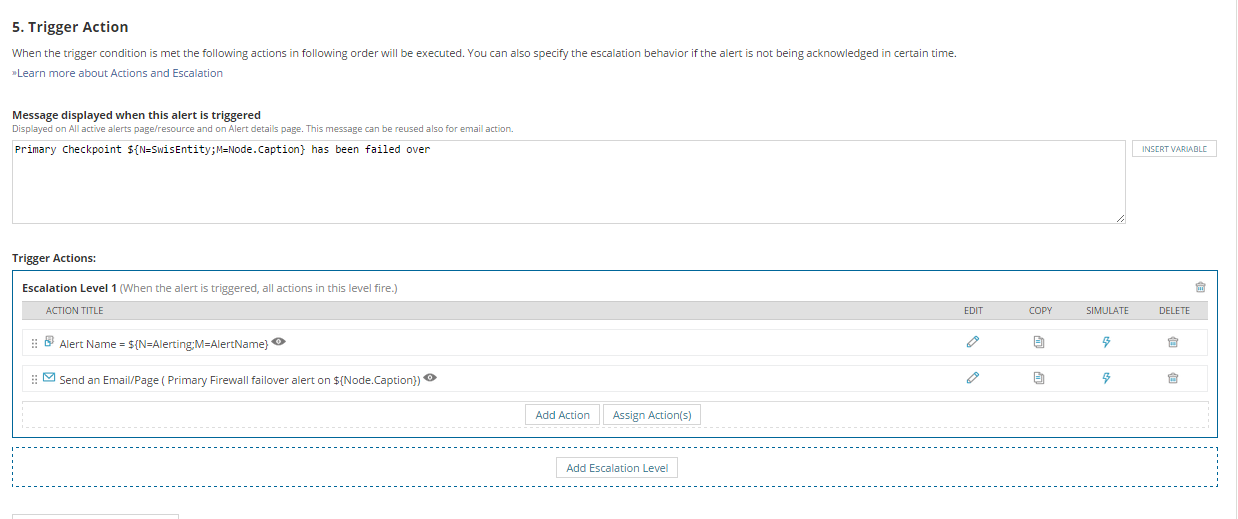

Actually this alert will target only Primary checkpoint firewall, because when primary firewall failed over to secondary firewall, you will receive such alert on console,
Alert Sanpshot -
here we have target only one node, but if you have multiple primary node, you can create a new custom property against the node, like "Pri_CheckPoint" and marked them "YES" all primary node.
And then same logic you can use in above created alert, where "Node - custom property - Pri_Checkpoint - YES"
Now your alert is ready to fire alert, but in "Trigger action" tab you can use the correct Netperfmon event log setting, So you/your team can get the correct naming details of alert in console.
