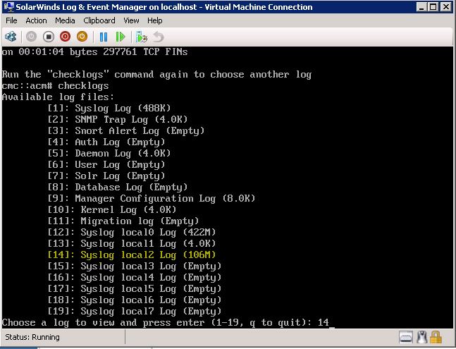

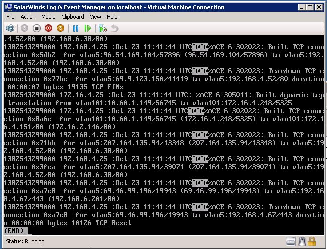

Hi, I've was told that the latest Cisco Firewall connector would be able to read the syslogs from the Cisco ACE 4710 Application Control Engine device. I set the facility to 18, which logs into local2 on LEM and I can see the syslogs messages when I use 'checklogs', but those messages are not showing up on the console.

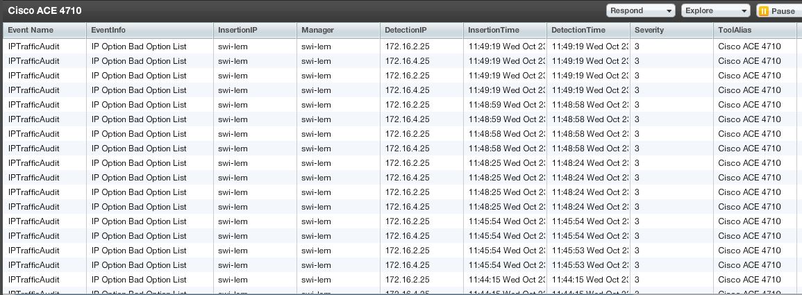

I created a filter to pick up any alerts with ToolAlias *Cisco*, but only a very small portion of the logs are displayed.
Has anyone been able to get LEM to display all the syslogs from this device?
