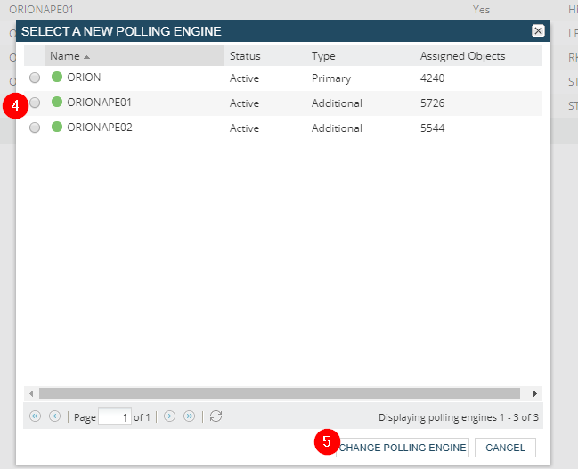

I have to move all of my switches and AP's to a new polling engine and was wondering if there was a way to do this without touching every device? Is there some method to do a batch move of devices to a new polling engine?
Thanks in advance!
bclower1963 On the manage nodes page...
(1) Select the nodes you want to move.
(2) Click the "More Actions" drop down box.
(3) Choose the "Change Polling Engine" option.
(4) Choose the Polling Engine you want to move your nodes to.
(5) Click the "Change Polling Engine" button towards the bottom of the pop up.
That should get your nodes moved over to a different polling engine, in bulk.
Thank you,
-Will
Thanks Will!
I/You nailed it.
Cheers
