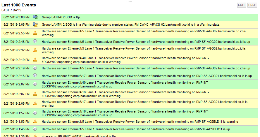

I have solarwind that always send warning or informational about transciever.How can I remove that? because its too disturb to have that alert
Thanks
I had the same problem too awhile back. I ended up turning off the offending Module Temperature Sensor. If you go to Admin/Manage Hardware Sensors and select the device you are monitoring, you will find a list of the sensors. You can turn off the individual sensor. Hope this helps.
