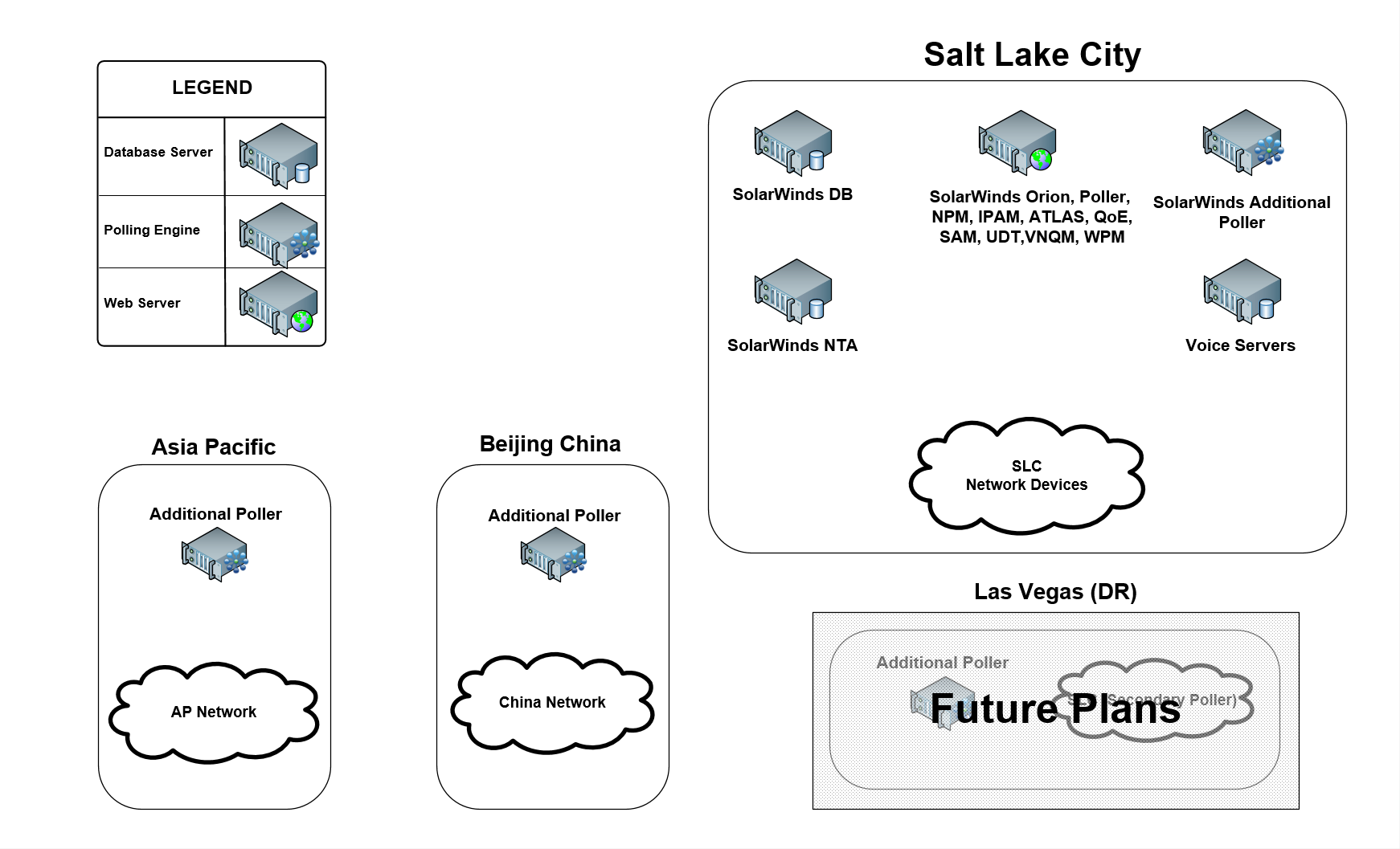

Hey everyone! I am very new to SolarWinds, and our current enterprise SolarWinds environment is very unstable and giving false alarms. I would like to know what we are doing wrong, and if a rebuild of our environment is a good solution for us. we are also looking to setup high availability, disaster recovery, and lab/test environment Q1 next year. We are having resource issues all the time with our additional polling engine and our main poller/Orion server. Any ideas would be helpful! Thank you! Here is a list of our current products and a overview of our setup:

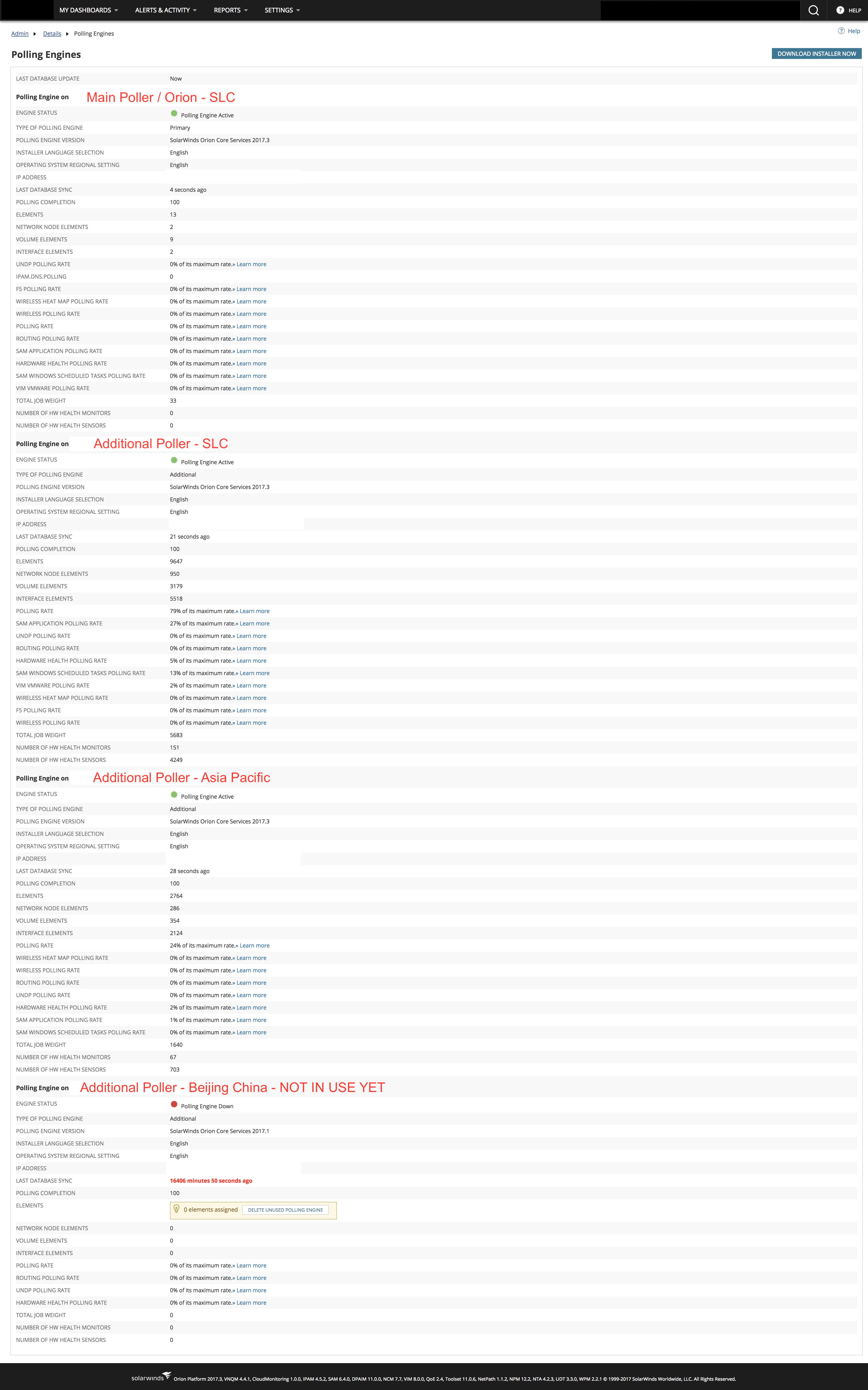

I would also add that your Pollers (if not regional or specifically used for certain devices) should be load balanced.
Even out the element count, and mainly watch the Job Weight (comparative value to see how hard your servers are working) and see if you can't bring those closer together between the two APEs.
You are doing well by keeping a light load on the Primary Engine.
