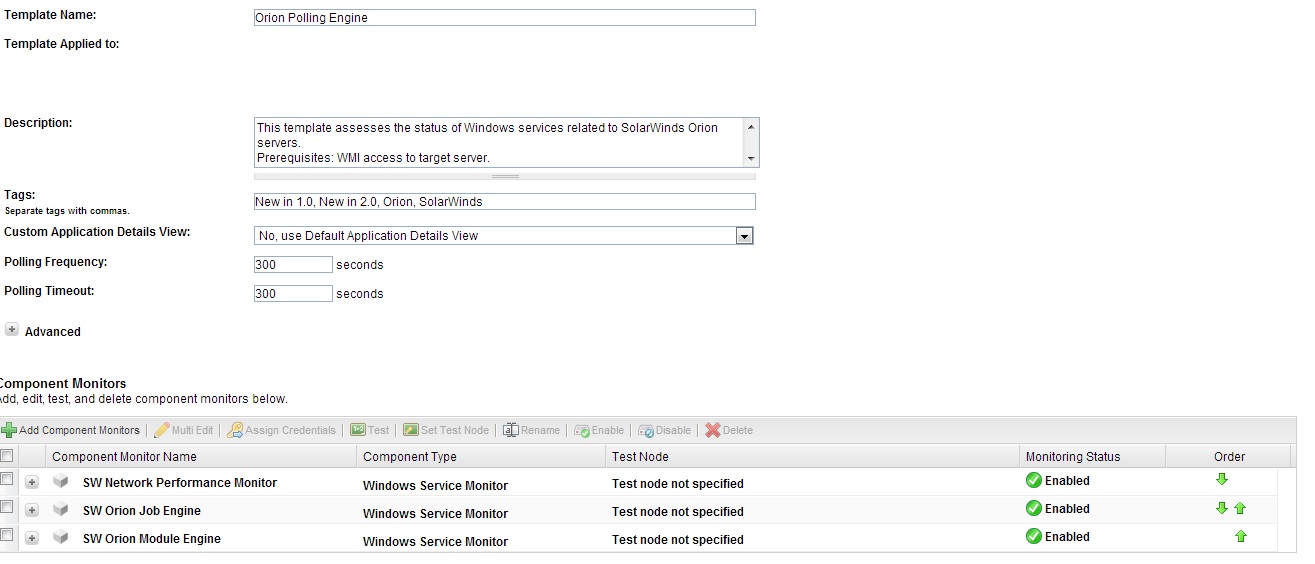

We are using this template to do SAM checks on a few of our polling boxes to monitor the Job and Module engines.
The weird issue we are having is that the check works on 2 of the 5 servers, but not on the other 3. The checks are set up the same. When you drill down to the individual components, "SW Job Engine" for example, it is giving the error "The WMI credentials are not valid. Unable to connect to server "IP ADDRESS" as user "" ". The thing is, the check does not use a service account one ANY of the servers, working or not. I have checked the WMI security settings and they match between the servers that work and don't. Has anyone ran into a similar issue?
