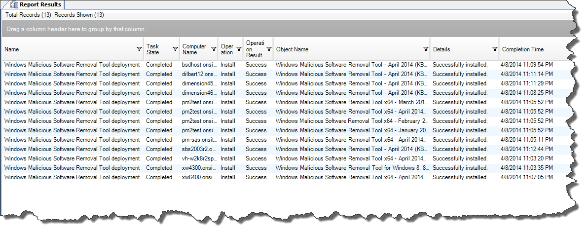

For many moons we've heard requests about having the ability to generate reports for updates that had been successfully installed. Unfortunately, this is not a function supported by WSUS natively; however, that information is available from Patch Manager if the updates were deployed using Patch Manager. In fact, as I just recently discovered, there's a SYSTEM report which shows "Computers with failed update installations", and it's fairly trivial to modify that report to provide "successful update installations this month". So here it is; I did it for you. :-)

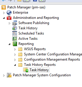

Please note that this report template should be imported into the TASK HISTORY report category under Task History Reports of the console:
