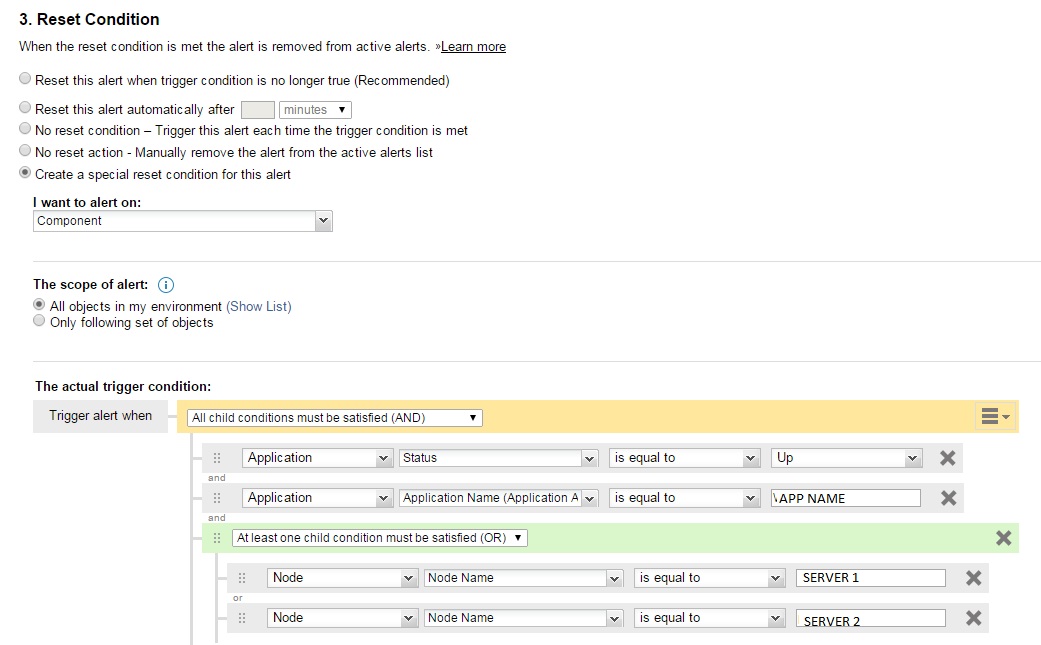

Hello,

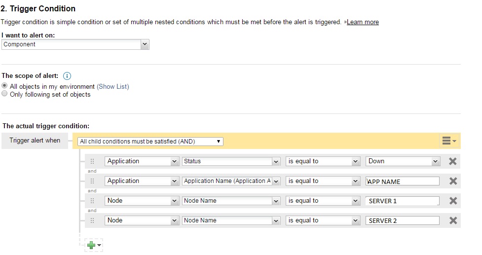

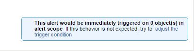

I'm trying to set up an alert that will alert on a SAM check that I have created that is assigned on two nodes. If the application is down on both nodes, I want it to alert. I want it to reset/recover when the application is up on at least one of the nodes. I think I have it set up correctly, but it is showing that 0 nodes will be affected on the summary page. Both application checks are showing down now (typo'd the service names for this to occur). Does anyone see anything that would cause this to not work like I'm expecting?
Here are some screenshots of the alert:
