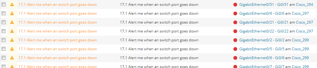

Solarwinds shows me many alerts for interfaces which are down because the the pc's connected to it were shut down.
The Problem is, that there are so many of these alerts that it's hard to identify an urgent interface down:

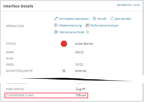

This is how a interface looks like and which field I want to filter:
But when modifying the altert definition, I can not find the field "assigned VLANs". I tried that to check if I can filter for a specific VLAN, but it does not work because it delivers also ports with multiple VLAN's:
I think the problem is, that the field "VLAN Name" is not from the type "interface" but "Node".
But how can I than access the field from the interface object? It must be there otherwise It couldn't be displayed.
