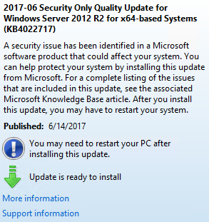

- Do you typically have MULTIPLE jobs for a deployment? I suppose I could run #3, then create and run a 2nd job for #2, but then I will manually have to kick off the 2nd job after being notified that the 1st job completed. OR -- I can maybe just rollout updates via both jobs over 2 days.
- Is there any way to tell if an update is a exclusive update or not? Right now, it seems like all updates say "You may need to restart your PC after installing this update" -- but I'm not sure if thats the same as an EXCLUSIVE update or not.
