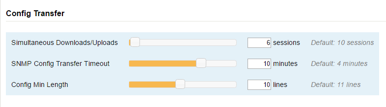

I've checked my NCM settings to ensure that the amount of ssh sessions at one time is limited to 4, and the snmp timeout is set to 10 minutes.
