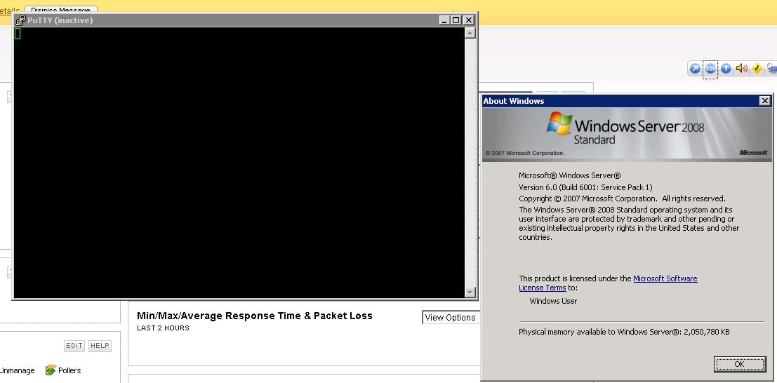

Apologies for the delay i was on holidays .:D .I have tested this with 2008 / windows 7 / Vista / 2003 and its working fine.
You mean there is not a "C:\System\PuTTY\putty.exe"? Then create one. or modify the path in the .reg file or to reflect the path to your copy of his putty .exe
Nice. Got it working on our server. Thanks Malik Haider for the information. Very helpful!
