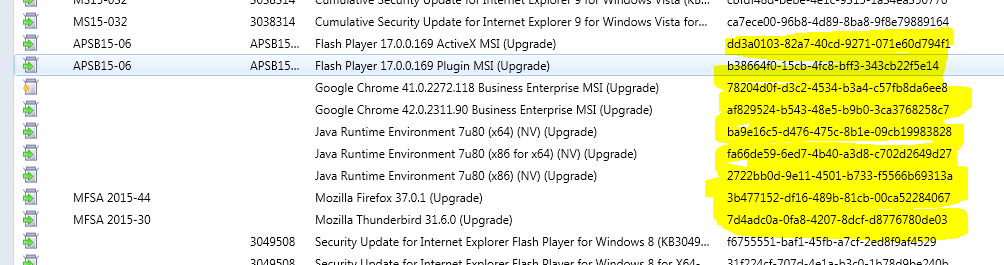

Can anyone help with this please? I have exhausted my research with this issue.
I have about 506 machine all fail to install 3rd party patches. The weird part is that 5 thousands other systems did not fail 3rd party patches. Windows Updates all install fine on those same systems.
I have tried the following below so far:
- Redistribute those packages to all DPs. Funny why I should do that if others in the same location install it fine, right. Still did not work.
- Check SCCM boundaries and did found few that are not in SCCM boundaries so some problem system. So I’ve added them to rule that out. Still did not work.
- Check to see if those systems got the appropriate certificates on them to authorized install 3rd parties patches. Found a few that don’t have them but even after install the certificates still will not install the 3rd parties patches.
Below are information on WindowsUpdate.log and CAS.log. of the error message on all of them.
3rd party Unique Update deployment ID: Snap shot

File 991922fa6b6d5d0c372a7630990c0b499d0c27ce.cab not expected in folder. ContentAccess 5/1/2015 6:04:06 PM 6848 (0x1AC0)
The content on the local cache location is not available anymore C:\Windows\ccmcache\2r. Try downloading later ContentAccess 5/1/2015 6:04:06 PM 6848 (0x1AC0)
Download failed for content dd3a0103-82a7-40cd-9271-071e60d794f1.1 under context System, error 0x80091007 ContentAccess 5/1/2015 6:04:06 PM 6848 (0x1AC0)
Download failed for download request {419FC2AC-48B4-4DFF-823F-55C25E4E6494} ContentAccess 5/1/2015 6:04:06 PM 6848 (0x1AC0)
Raising event:
[SMS_CodePage(437), SMS_LocaleID(1033)]
instance of SoftDistHashMismatchEvent
ClientID = "GUID:CA3EE87A-C88C-495A-98D1-E5EB921B60C0";
DateTime = "20150502010406.182000+000";
MachineName = "AKRAMER-DT";
PackageId = "dd3a0103-82a7-40cd-9271-071e60d794f1";
PackageName = "dd3a0103-82a7-40cd-9271-071e60d794f1";
PackageVersion = "1";
ProcessID = 3028;
SiteCode = "US1";
ThreadID = 6848;
Successfully raised SoftDistHashMismatchEvent event. ContentAccess 5/1/2015 6:04:06 PM 6848 (0x1AC0)
Error: DeleteDirectory:- Failed to delete Directory with Error 0x00000003. ContentAccess 5/1/2015 6:04:06 PM 6848 (0x1AC0)
Error: DeleteDirectory:- Failed to delete Directory C:\Windows\ccmcache\2r.BCWork with Error 0x00000002. ContentAccess 5/1/2015 6:04:06 PM 6848 (0x1AC0)
Releasing content request {419FC2AC-48B4-4DFF-823F-55C25E4E6494} ContentAccess 5/1/2015 6:04:06 PM 6848 (0x1AC0)
Download completed for content fa66de59-6ed7-4b40-a3d8-c702d2649d27.1 under context System ContentAccess 5/1/2015 6:04:27 PM 6848 (0x1AC0)
File c862fc4a745ea422b47100ea706c81901dff7188.cab not expected in folder. ContentAccess 5/1/2015 6:04:27 PM 6848 (0x1AC0)
The content on the local cache location is not available anymore C:\Windows\ccmcache\2s. Try downloading later ContentAccess 5/1/2015 6:04:27 PM 6848 (0x1AC0)
Download failed for content fa66de59-6ed7-4b40-a3d8-c702d2649d27.1 under context System, error 0x80091007 ContentAccess 5/1/2015 6:04:27 PM 6848 (0x1AC0)
Download failed for download request {F0B965F7-DFA1-4EA5-B2BB-41BB099350F3} ContentAccess 5/1/2015 6:04:27 PM 6848 (0x1AC0)
Raising event:
DateTime = "20150502010427.924000+000";
PackageId = "fa66de59-6ed7-4b40-a3d8-c702d2649d27";
PackageName = "fa66de59-6ed7-4b40-a3d8-c702d2649d27";
ProcessID = 3028;
SiteCode = "US1";
ThreadID = 6848;
Successfully raised SoftDistHashMismatchEvent event. ContentAccess 5/1/2015 6:04:27 PM 6848 (0x1AC0)
Error: DeleteDirectory:- Failed to delete Directory with Error 0x00000003. ContentAccess 5/1/2015 6:04:27 PM 6848 (0x1AC0)
Error: DeleteDirectory:- Failed to delete Directory C:\Windows\ccmcache\2s.BCWork with Error 0x00000002. ContentAccess 5/1/2015 6:04:27 PM 6848 (0x1AC0)
Releasing content request {F0B965F7-DFA1-4EA5-B2BB-41BB099350F3} ContentAccess 5/1/2015 6:04:27 PM 6848 (0x1AC0)
Download completed for content b38664f0-15cb-4fc8-bff3-343cb22f5e14.1 under context System ContentAccess 5/1/2015 6:04:42 PM 6848 (0x1AC0)
File f056c2654b514358eaa41c1476b69dbefa7e46e4.cab not expected in folder. ContentAccess 5/1/2015 6:04:42 PM 6848 (0x1AC0)
The content on the local cache location is not available anymore C:\Windows\ccmcache\2q. Try downloading later ContentAccess 5/1/2015 6:04:42 PM 6848 (0x1AC0)
Download failed for content b38664f0-15cb-4fc8-bff3-343cb22f5e14.1 under context System, error 0x80091007 ContentAccess 5/1/2015 6:04:42 PM 6848 (0x1AC0)
Download failed for download request {3F80E3C0-9BAC-446F-ADCC-7BABCE8F89B5} ContentAccess 5/1/2015 6:04:42 PM 6848 (0x1AC0)
Raising event:
DateTime = "20150502010442.480000+000";
PackageId = "b38664f0-15cb-4fc8-bff3-343cb22f5e14";
PackageName = "b38664f0-15cb-4fc8-bff3-343cb22f5e14";
ProcessID = 3028;
SiteCode = "US1";
ThreadID = 6848;
Successfully raised SoftDistHashMismatchEvent event. ContentAccess 5/1/2015 6:04:42 PM 6848 (0x1AC0)
Error: DeleteDirectory:- Failed to delete Directory with Error 0x00000003. ContentAccess 5/1/2015 6:04:42 PM 6848 (0x1AC0)
Error: DeleteDirectory:- Failed to delete Directory C:\Windows\ccmcache\2q.BCWork with Error 0x00000002. ContentAccess 5/1/2015 6:04:42 PM 6848 (0x1AC0)
Releasing content request {3F80E3C0-9BAC-446F-ADCC-7BABCE8F89B5} ContentAccess 5/1/2015 6:04:42 PM 6848 (0x1AC0)
Requesting content b38664f0-15cb-4fc8-bff3-343cb22f5e14.1, size(KB) 0, under context System with priority Medium ContentAccess 5/1/2015 6:04:43 PM 5832 (0x16C8)
User policy requested with no user credentials. ContentAccess 5/1/2015 6:04:43 PM 5832 (0x16C8)
Invalid user. ContentAccess 5/1/2015 6:04:44 PM 5832 (0x16C8)
Submitted CTM job {6C456BC3-998E-44CB-B0BC-16E3A3EC2C1C} to download Content b38664f0-15cb-4fc8-bff3-343cb22f5e14.1 under context System ContentAccess 5/1/2015 6:04:44 PM 5832 (0x16C8)
Successfully created download request {16EF5A2C-CED9-44B6-BCBF-9A689A7D2C7A} for content b38664f0-15cb-4fc8-bff3-343cb22f5e14.1 ContentAccess 5/1/2015 6:04:44 PM 5832 (0x16C8)
Requesting content dd3a0103-82a7-40cd-9271-071e60d794f1.1, size(KB) 0, under context System with priority Medium ContentAccess 5/1/2015 6:04:44 PM 5832 (0x16C8)
User policy requested with no user credentials. ContentAccess 5/1/2015 6:04:44 PM 5832 (0x16C8)
Submitted CTM job {384AF1FC-EC61-4CB5-9DA3-9BDD4DC2ED89} to download Content dd3a0103-82a7-40cd-9271-071e60d794f1.1 under context System ContentAccess 5/1/2015 6:04:44 PM 5832 (0x16C8)
Successfully created download request {ADE7D84D-7E27-4348-963F-4AC4600508BF} for content dd3a0103-82a7-40cd-9271-071e60d794f1.1 ContentAccess 5/1/2015 6:04:44 PM 5832 (0x16C8)
Requesting content fa66de59-6ed7-4b40-a3d8-c702d2649d27.1, size(KB) 0, under context System with priority Medium ContentAccess 5/1/2015 6:04:45 PM 5832 (0x16C8)
User policy requested with no user credentials. ContentAccess 5/1/2015 6:04:45 PM 5832 (0x16C8)
Invalid user. ContentAccess 5/1/2015 6:04:45 PM 5832 (0x16C8)
Submitted CTM job {4D526922-634F-4987-BC2B-E0C39059243C} to download Content fa66de59-6ed7-4b40-a3d8-c702d2649d27.1 under context System ContentAccess 5/1/2015 6:04:45 PM 5832 (0x16C8)
Successfully created download request {C342B85E-9774-4FEB-8045-D35648D887B8} for content fa66de59-6ed7-4b40-a3d8-c702d2649d27.1 ContentAccess 5/1/2015 6:04:45 PM 5832 (0x16C8)
Location update from CTM for content b38664f0-15cb-4fc8-bff3-343cb22f5e14.1 and request {16EF5A2C-CED9-44B6-BCBF-9A689A7D2C7A} ContentAccess 5/1/2015 6:04:45 PM 6940 (0x1B1C)
Download location found 0 - net:http://<Sever Name>.<Company Name>/Content/E4/F056C2654B514358EAA41C1476B69DBEFA7E46E4.cab ContentAccess 5/1/2015 6:04:45 PM 6940 (0x1B1C)
Download request only, ignoring location update ContentAccess 5/1/2015 6:04:45 PM 6940 (0x1B1C)
Location update from CTM for content dd3a0103-82a7-40cd-9271-071e60d794f1.1 and request {ADE7D84D-7E27-4348-963F-4AC4600508BF} ContentAccess 5/1/2015 6:04:45 PM 2972 (0x0B9C)
Download location found 0 - net:http://<Sever Name>.<Company Name>/Content/CE/991922FA6B6D5D0C372A7630990C0B499D0C27CE.cab ContentAccess 5/1/2015 6:04:45 PM 2972 (0x0B9C)
Download request only, ignoring location update ContentAccess 5/1/2015 6:04:45 PM 2972 (0x0B9C)
Download started for content dd3a0103-82a7-40cd-9271-071e60d794f1.1 ContentAccess 5/1/2015 6:04:45 PM 7508 (0x1D54)
Download started for content b38664f0-15cb-4fc8-bff3-343cb22f5e14.1 ContentAccess 5/1/2015 6:04:45 PM 7612 (0x1DBC)
Location update from CTM for content fa66de59-6ed7-4b40-a3d8-c702d2649d27.1 and request {C342B85E-9774-4FEB-8045-D35648D887B8} ContentAccess 5/1/2015 6:04:45 PM 6892 (0x1AEC)
Download location found 0 - net:http://<Sever Name>.<Company Name>/Content/88/C862FC4A745EA422B47100EA706C81901DFF7188.cab ContentAccess 5/1/2015 6:04:45 PM 6892 (0x1AEC)
Download request only, ignoring location update ContentAccess 5/1/2015 6:04:45 PM 6892 (0x1AEC)
Download started for content fa66de59-6ed7-4b40-a3d8-c702d2649d27.1 ContentAccess 5/1/2015 6:04:45 PM 7612 (0x1DBC)
Download completed for content dd3a0103-82a7-40cd-9271-071e60d794f1.1 under context System ContentAccess 5/1/2015 6:04:59 PM 2972 (0x0B9C)
File 991922fa6b6d5d0c372a7630990c0b499d0c27ce.cab not expected in folder. ContentAccess 5/1/2015 6:04:59 PM 2972 (0x0B9C)
The content on the local cache location is not available anymore C:\Windows\ccmcache\2u. Try downloading later ContentAccess 5/1/2015 6:04:59 PM 2972 (0x0B9C)
Download failed for content dd3a0103-82a7-40cd-9271-071e60d794f1.1 under context System, error 0x80091007 ContentAccess 5/1/2015 6:04:59 PM 2972 (0x0B9C)
Download failed for download request {ADE7D84D-7E27-4348-963F-4AC4600508BF} ContentAccess 5/1/2015 6:04:59 PM 2972 (0x0B9C)
Raising event:
DateTime = "20150502010459.380000+000";
ProcessID = 3028;
SiteCode = "US1";
ThreadID = 2972;
Successfully raised SoftDistHashMismatchEvent event. ContentAccess 5/1/2015 6:04:59 PM 2972 (0x0B9C)
Error: DeleteDirectory:- Failed to delete Directory with Error 0x00000003. ContentAccess 5/1/2015 6:04:59 PM 2972 (0x0B9C)
Error: DeleteDirectory:- Failed to delete Directory C:\Windows\ccmcache\2u.BCWork with Error 0x00000002. ContentAccess 5/1/2015 6:04:59 PM 2972 (0x0B9C)
Releasing content request {ADE7D84D-7E27-4348-963F-4AC4600508BF} ContentAccess 5/1/2015 6:04:59 PM 2972 (0x0B9C)
Download completed for content b38664f0-15cb-4fc8-bff3-343cb22f5e14.1 under context System ContentAccess 5/1/2015 6:05:13 PM 6940 (0x1B1C)
File f056c2654b514358eaa41c1476b69dbefa7e46e4.cab not expected in folder. ContentAccess 5/1/2015 6:05:13 PM 6940 (0x1B1C)
The content on the local cache location is not available anymore C:\Windows\ccmcache\2t. Try downloading later ContentAccess 5/1/2015 6:05:13 PM 6940 (0x1B1C)
Download failed for content b38664f0-15cb-4fc8-bff3-343cb22f5e14.1 under context System, error 0x80091007 ContentAccess 5/1/2015 6:05:13 PM 6940 (0x1B1C)
Download failed for download request {16EF5A2C-CED9-44B6-BCBF-9A689A7D2C7A} ContentAccess 5/1/2015 6:05:13 PM 6940 (0x1B1C)
Raising event:
DateTime = "20150502010513.868000+000";
ProcessID = 3028;
SiteCode = "US1";
ThreadID = 6940;
Successfully raised SoftDistHashMismatchEvent event. ContentAccess 5/1/2015 6:05:13 PM 6940 (0x1B1C)
Error: DeleteDirectory:- Failed to delete Directory with Error 0x00000003. ContentAccess 5/1/2015 6:05:13 PM 6940 (0x1B1C)
Error: DeleteDirectory:- Failed to delete Directory C:\Windows\ccmcache\2t.BCWork with Error 0x00000002. ContentAccess 5/1/2015 6:05:13 PM 6940 (0x1B1C)
Releasing content request {16EF5A2C-CED9-44B6-BCBF-9A689A7D2C7A} ContentAccess 5/1/2015 6:05:13 PM 6940 (0x1B1C)
Download completed for content fa66de59-6ed7-4b40-a3d8-c702d2649d27.1 under context System ContentAccess 5/1/2015 6:05:35 PM 7104 (0x1BC0)
File c862fc4a745ea422b47100ea706c81901dff7188.cab not expected in folder. ContentAccess 5/1/2015 6:05:35 PM 7104 (0x1BC0)
The content on the local cache location is not available anymore C:\Windows\ccmcache\2v. Try downloading later ContentAccess 5/1/2015 6:05:35 PM 7104 (0x1BC0)
Download failed for content fa66de59-6ed7-4b40-a3d8-c702d2649d27.1 under context System, error 0x80091007 ContentAccess 5/1/2015 6:05:35 P
Any other suggestion?
