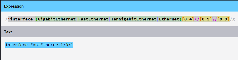

Just getting started this is what I have come up with so far
^interface (GigabitEthernet|FastEthernet|TenGigabitEthernet|Ethernet)[0-4]\/[0-9]\/[0-9]
