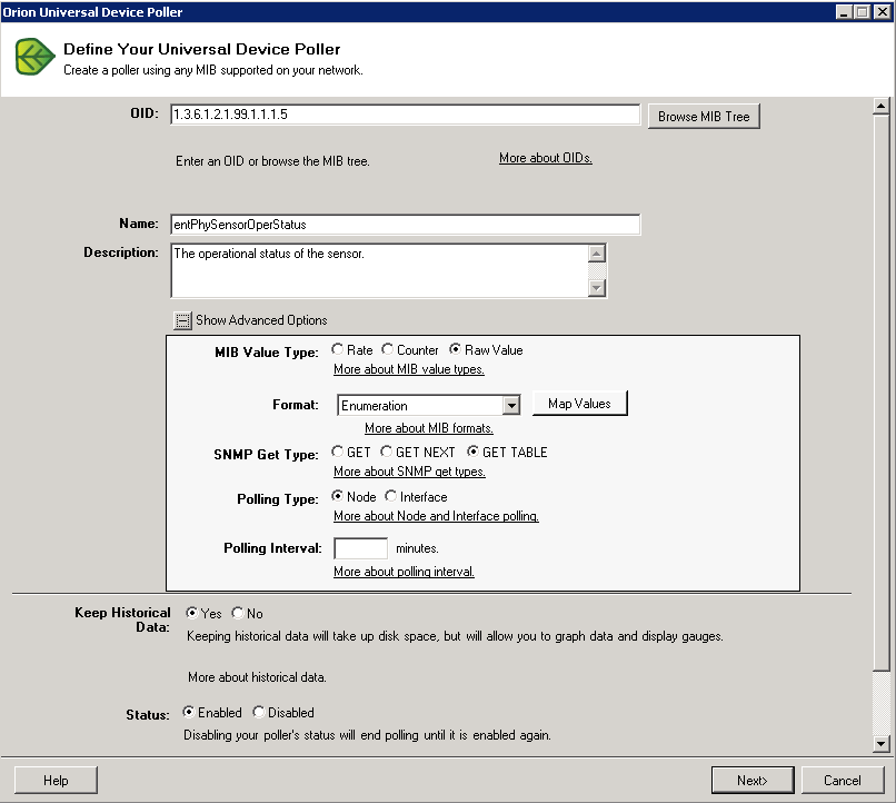

In order to create the alert, first I had to monitor for the data. Cisco provided the OID 1.3.6.1.2.1.99.1.1.1, which is a range. After some research, I found 1.3.6.1.2.1.99.1.1.1.5 to be the best option for what I was after. It performs a GET TABLE request against the hardware status of the device.

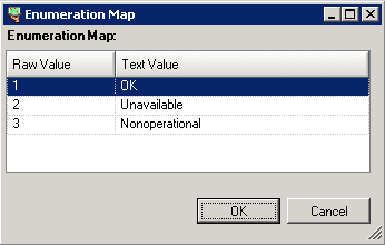

Notice the enumeration. It's there to give the users an easier reading experience and so they don't have to reference what the numbers stand for. A quick use of Cisco's MIB browser gave me the values and what they stood for:

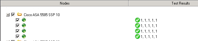

Testing it on a few 5585's give some positive results:

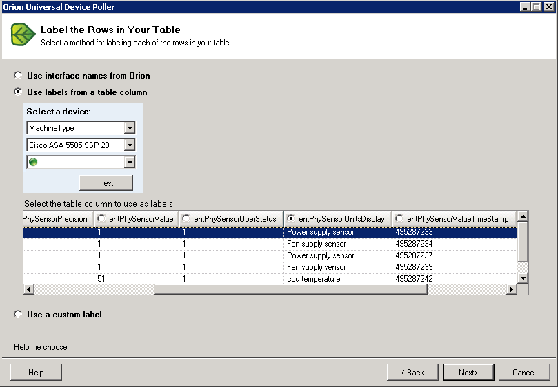

Let's give those values their relative labels. Using this method ensures the labels are dynamic since the sensor types or values could vary between devices:

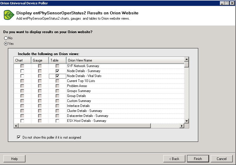

I want them displayed on the nodes' web pages so the teams can see the data anytime they want:

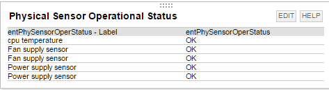

Display on the node page:

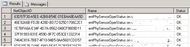

Let's start with getting the base query correct:
| Query |
SELECT DISTINCT CustomPollerAssignmentView.CustomPollerAssignmentID AS NetObjectID,CustomPollerAssignmentView.AssignmentName AS Name,CustomPollerStatus.Status AS Status FROM (CustomPollerStatus INNER JOIN CustomPollerAssignmentView ON (CustomPollerStatus.CustomPollerAssignmentID = CustomPollerAssignmentView.CustomPollerAssignmentID)) LEFT OUTER JOIN CustomPollers ON (CustomPollerAssignmentView.CustomPollerID = CustomPollers.CustomPollerID) WHERE ( (CustomPollers.UniqueName = 'entPhySensorOperStatus') AND (CustomPollerStatus.Status = 'OK')) |
The above portion shows why I couldn't just call these fields into a normal alert trigger and go from there. The trigger will have to be "smart" enough to join the poller node assignments to the custom poller and be aware of the enumeration.

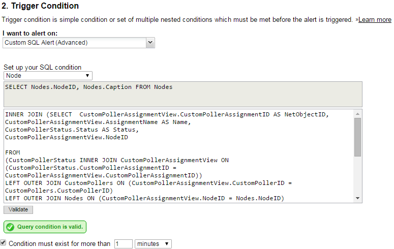

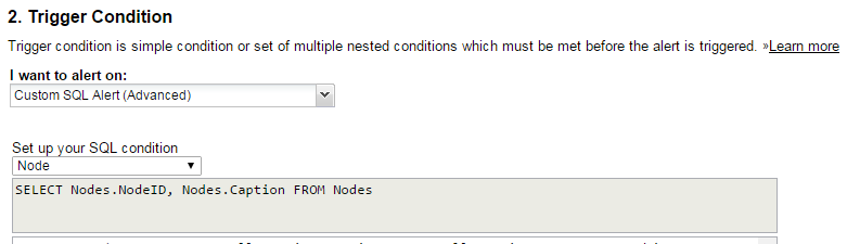

Cool. Our query is correct so let's just copy that into the SQL field on the alert...wait a second...what's this??
Now, I've heard there are ways to manipulate this. In the interest of time, it was easier for me to make my query tie into the static SELECT above.
A little INNER JOIN here, a little stitching there, ahh...here we go:
SELECT Nodes.NodeID, Nodes.Caption FROM NodesINNER JOIN (SELECT CustomPollerAssignmentView.CustomPollerAssignmentID AS NetObjectID,CustomPollerAssignmentView.AssignmentName AS Name,CustomPollerStatus.Status AS Status,CustomPollerAssignmentView.NodeIDFROM(CustomPollerStatus INNER JOIN CustomPollerAssignmentView ON (CustomPollerStatus.CustomPollerAssignmentID = CustomPollerAssignmentView.CustomPollerAssignmentID)) LEFT OUTER JOIN CustomPollers ON (CustomPollerAssignmentView.CustomPollerID = CustomPollers.CustomPollerID)LEFT OUTER JOIN Nodes ON (CustomPollerAssignmentView.NodeID = Nodes.NodeID)WHERE( (CustomPollers.UniqueName = 'entPhySensorOperStatus') AND (CustomPollerStatus.Status <> 'OK') AND (Nodes.MachineType like '%5585%'))GROUP BY CustomPollerAssignmentView.NodeID, CustomPollerStatus.Status, CustomPollerAssignmentView.AssignmentName, CustomPollerAssignmentView.CustomPollerAssignmentID) CMON CM.NodeID = NODES.NodeID
I could've cleaned my joined SELECT statement up a bit but it works. Since Line 1 is untouchable, I had to INNER JOIN my base query to theirs. This allowed me to maintain the correct data and align to theirs. Notice the added JOIN statement to the FROM field in the base query.
A quick copy and paste into the alert and let's validate. Success:

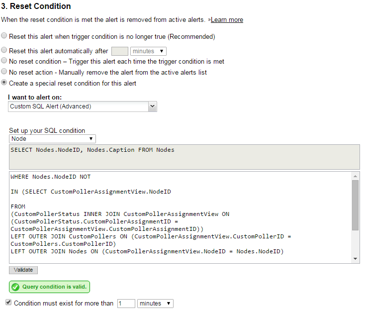

Now to the reset condition. Thanks to RichardLetts for pointing out the flaw in the automatic reset conditions not working properly, I knew to double check Solarwinds here. Since the query is somewhat complex, when I chose "Create a special reset condition for this alert", it auto-generated my trigger condition as it was back into the box. What they try to do is understand your query and negate it. This works great for basic queries like "WHERE NOT nodeid" or something similar, this was beyond what it could recognize.
The reset I used reversed my "OK" WHERE clause by using a WHERE NOT, which concluded as (CustomPollerStatus.Status = 'OK'):
SELECT Nodes.NodeID, Nodes.Caption FROM NodesWHERE Nodes.NodeID NOTIN (SELECT CustomPollerAssignmentView.NodeIDFROM(CustomPollerStatus INNER JOIN CustomPollerAssignmentView ON (CustomPollerStatus.CustomPollerAssignmentID = CustomPollerAssignmentView.CustomPollerAssignmentID)) LEFT OUTER JOIN CustomPollers ON (CustomPollerAssignmentView.CustomPollerID = CustomPollers.CustomPollerID)WHERE( (CustomPollers.UniqueName = 'entPhySensorOperStatus') AND (CustomPollerStatus.Status <> 'OK')))
This query contains a WHERE NOT that looks for the NodeID to be present in the previous "not OK" table. I guess two wrongs do make a right! If the NodeID is not "NOT OK" then it must be OK!
Another validation success:
