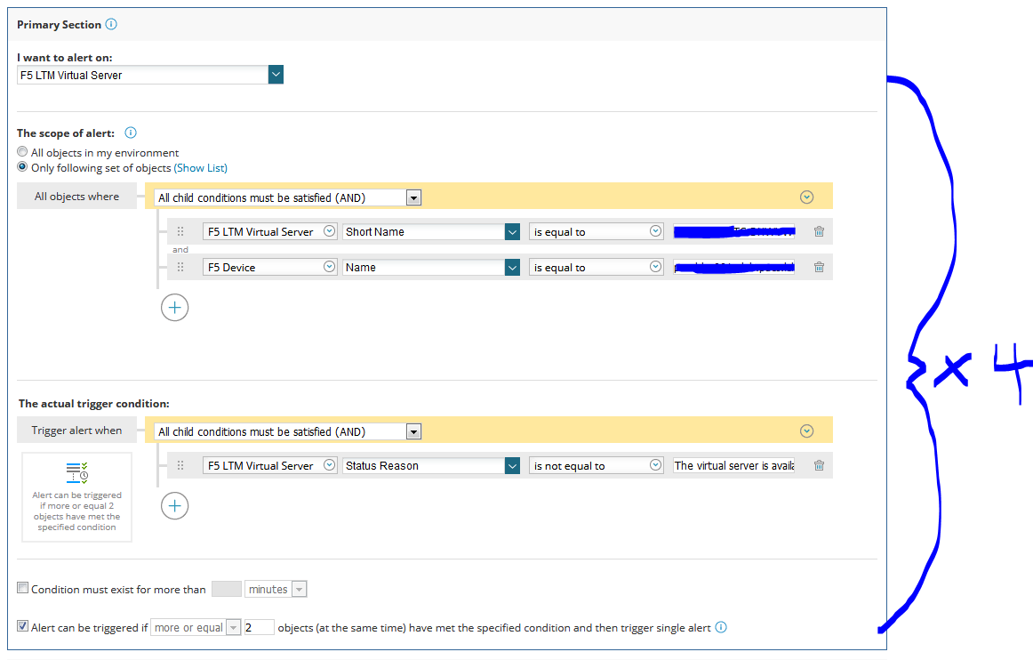

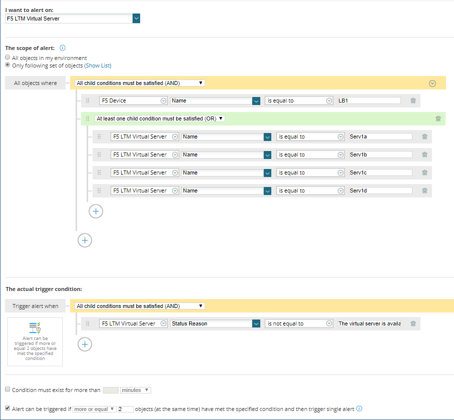

Question, is it possible to create an alert that triggers when say, any 2 out of 4 F5 virtual servers have gone down?
The background:
I'm not sure I understand how the complex trigger conditions work. I've read the admin guide on it, but as always its somewhat lacking.
I've created an alert to trigger on the scenario in my question above, but its just not firing.
I've adjusted F5 polling to 3 minutes so we get Virtual Server statistics every 3 minutes.
I've set the Evaluation of the alert to 3 minutes to match polling.
In my alert I've enabled complex conditions and configured 4 "objects" that will trigger when a particular virtual server on the same F5 has gone down
I've set the 'condition must exist for' option to null so it fires intermediately
The X4 below indicates I've created the 4 objects all relating to the same F5 but a different Virtual Server:
I also don't understand this setting:
This sounds like exactly what I need to be able to trigger on 2 out of any 4 "objects" but why is this setting set at EACH object? Shouldn't this be set globally to the alert or am I missing something?
I've tested the SWQL for each object and it is Valid
