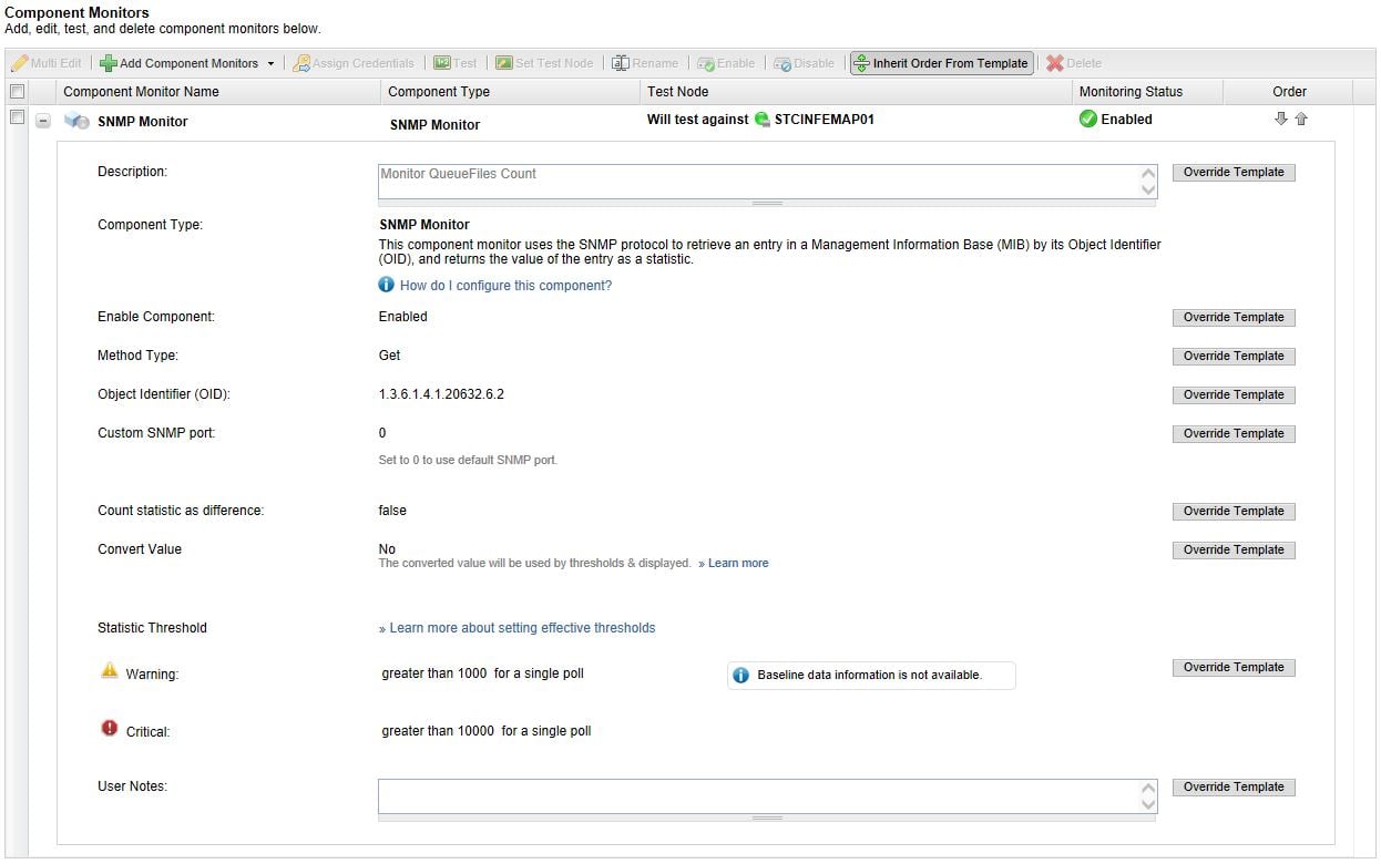

I made a new template, added a SNMP monitor to it, and filled in the blanks with the OID, etc. When I run it, I get "SNMP Monitor execution error. Generic Error" in red.
Screenshot below of the monitor:

I've attached the two mib files that Barracuda provides. If I am reading them right, these are really the main three items I should be able to get:
Objects:
* 1.3.6.1.4.1.20632.6.2 -- QueueFiles
* 1.3.6.1.4.1.20632.6.3 -- UnfinishedFiles
* 1.3.6.1.4.1.20632.6.4 -- IndexCount
When I do a snmpget against the appliance it can't find .2 and has no values for .3 and .4 ...
OID=.1.3.6.1.4.1.20632.6.2
Failed to get value of SNMP variable. Timeout.
