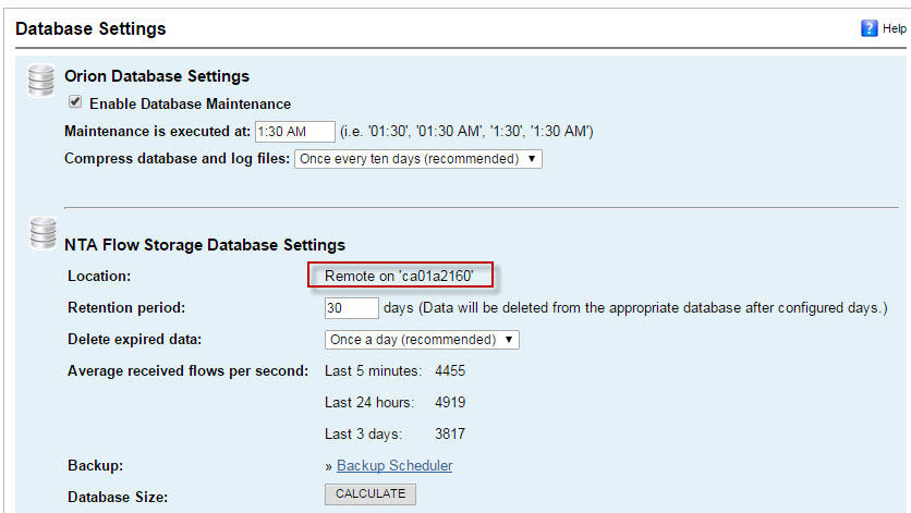

Sure, your NTA flow store database is probably on a different server. Log into that server and apply the update first, then go back to the main orion server and apply the update there.
I checked the database information and see that it's on the same server.
Any thoughts on why I'm still getting that error?
So when you check Under NTA Settings, Database Settings, you see the location of the database is Local and not remote?

Thank you all. I managed to get the update done.
The database is on a separate server - I just didn't know where that was.
My NTA is now up to date. I appreciate your help.
you need first to upgrade you NTA flow storage database server which i sense it is on a separate server before you can upgrade the NTA application to 4.1.1.
Just use the same installer NTA 4.1.1 for upgrading both NTA app and NTA database.
