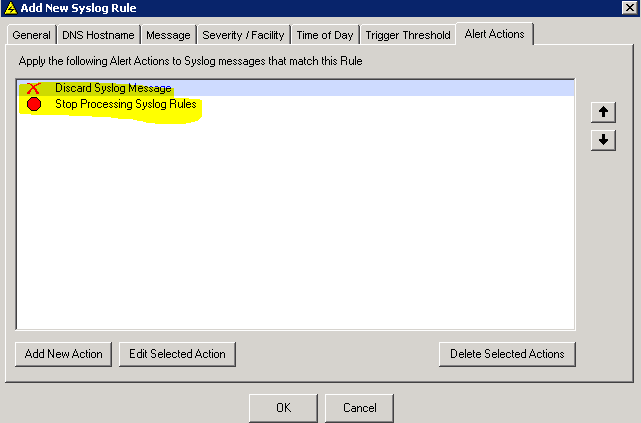

Also, look for traps being received by the Trap Viewer that you are not interested in keeping - you can create a new Rules based on these Traps by right-clicking and choosing Add Rule, to discard those messages. It should automatically will out all tabs of the new rule to match that trap exactly. Use wildcards ( * ) as appropriate to expand what the rule will match to. Add the actions to "Discard the Trap Message" and to "Stop processing Trap rules".
Trap rules are checked in order top-to-bottom - placing these discard rules at the top of the list will ensure that these messages are discarded first, and that no other rules are checked against those messages.

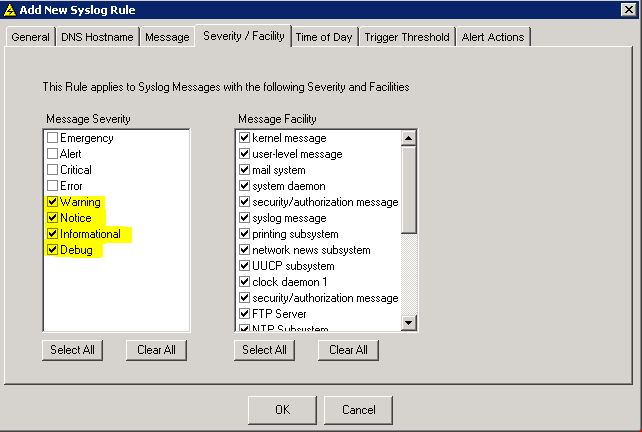

Option 2 Edit Your Syslog Retention Settings to keep Syslogs for x Days. I would suggest you tune the Severity levels for the Syslog output on your devices to Warning or above. Launch the Syslog view on the server and go to Server Settings. On the first tab you have a keep data for an amount of days option. Reduce this.

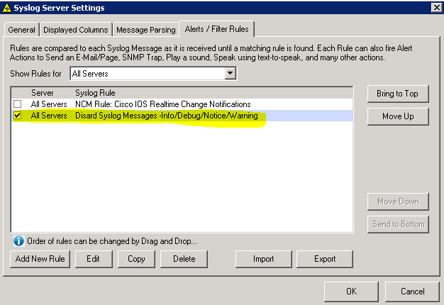

Option 4 Syslog Message comes to Orion, Syslog Service. Using Rules from Syslog Viewer to Determine whether you want to Store the Syslog message in the Database or whether to discard message.
If you have a definite need for level 5 (notice) or above, you will have to look at the data retention settings in the Syslog application within Orion. Alternatively you could use filter Rules so that the ones which filter and discard messages, are at the top of the list. This will ensure that they are processed first.
I recommend to make sure that all rules which are set up to “Discard messages” also contain the line "Stop processing syslog rules".
The syslog and traps filter/rules work very differently to the Orion alerting engine. Each time a syslog message or trap is received it will work through every rule, from the top, until it either gets to the end, or hit a rule that specifically tells it to "stop processing rules".
"Discard Syslog Message"
Start -> Program Files -> Solarwinds -> Orion -> Syslog Viewer
From this tool, Goto File -> Syslog Server settings -> Alert/Filter Rules Tab
In here you can filter using various methods, By IP address, by Message Type Patterns, Syslog Message Patterns, Severity, etc…
And then Add the following Alert Actions to your Rule: "Discard Syslog Message" "Stop processing syslog rules"
"Stop processing syslog rules" Rearrange the syslog rules so that the ones which filter and discard messages, are at the top of the list. This will ensure that they are processed first.
