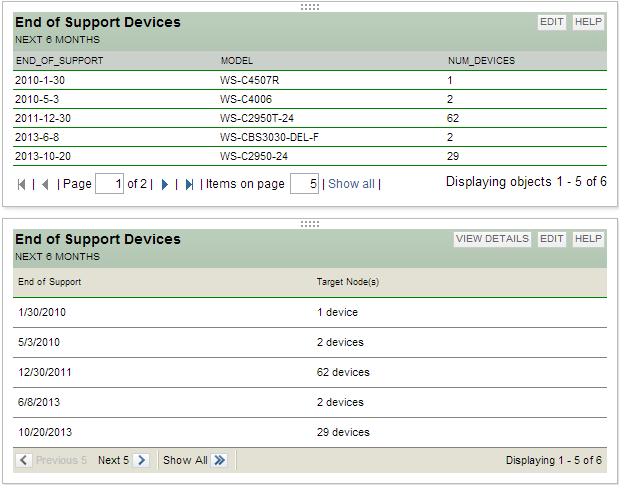

Ok, have been sick of the built-in "End-Of-Support" devices view, it's pretty worthless. Gives you the date and the # of devices, but nothing else about them! Worse yet, if you click on the "X devices" under "Target Node(s)", it just takes you the "End of Support & End of Sales Lookup", but doesn't show you what the "X" devices were! So, in the example below, the bottom one is the default view, the top one is my customized view. In the bottom one you have no idea that you have 62 WS-C2950T-24's that are End-Of-Support, you just know there are 62 devices.
Ok, my query gives you a bit more info. I haven't figured out how to get the "62" under Num_Devices to take you right to a page that shows you the qty-62 2950T-24's, so that link still just takes you to basically the same place the default view takes you. But, at least you have the switch model # known before you go there. Plus, click on the model # and if there was a URL associated with the EOS in the database, clicking on it will take you to that URL. I put in the Cisco EOS notice in the ones I did manually.
Bonus, its a more compact view also, takes up about 75% of what the default view did for the same # of items (5). If you increased the # of lines viewed in the Custom SQL, it would probably save even more room. I was going to put this in the "Content Exchange", but I didn't really see anything that applied under NCM. Nothing for putting up queries or views...
