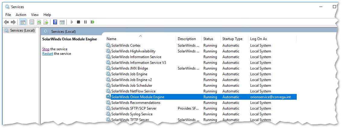

3. You will need to change one SolarWinds service on Orion to run as a user account and not 'Local System.' Here is a screenshot of the service that you'll need to change. I created an AD account and set the service to run at that, that account also needs to be a member of the local administrator group. Once that service is updated you need to restart it.

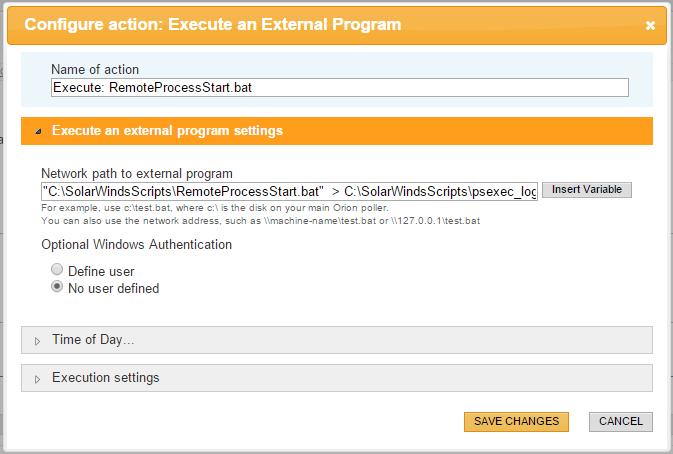

This is what I have for my Alert Trigger Action: Execute An External Program
The full text is:
"C:\SolarWindsScripts\RemoteProcessStart.bat" > C:\SolarWindsScripts\psexec_log.txt 2>&1
The second half of that line, "> C:\SolarWindsScripts\psexec_log.txt 2>&1" is just a redirection of output so that I could see details from psexec. It's optional to include it but handy if you need to troubleshoot anything.
