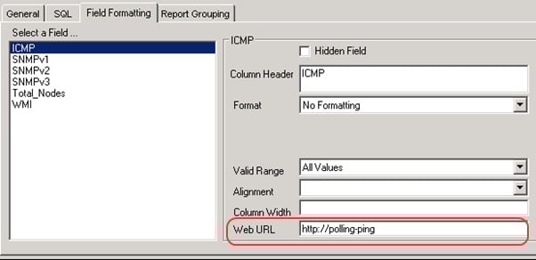

In the “Field Formatting” you need add “Web URL” for each data you want to send to Google chart. This is for parsing data out from the report later in the asp page. Here I am using dummy URL, you can using real links to link your table/chart to another Solarwinds page.

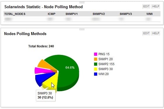

Step 4: In Solarwinds, create a view page and add two resources: “Report from Orion Report Writer” and “Custom HTML”
Edit “Report from Orion Report Writer”, Link the report to the report you just created
Edit “Custon HTML”, add the following code: (replace with your asp page link)
<iframe src="link-to-your-asp-page/solarsta.asp" width=550 height=250 frameborder=0 scrolling="no"></iframe>
View your chart in the view page. Done!

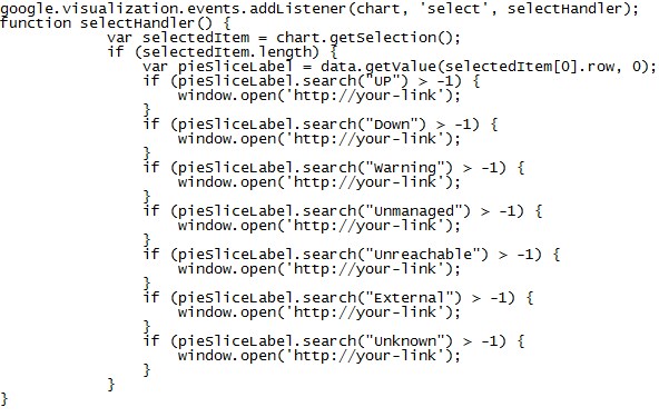

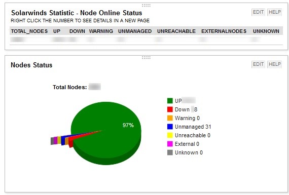

You can use the similar method to create different chats, such as Node status pie chart. Also you can make the chart click-able to link to other pages. Just add the following code in asp page after JavaScript function “chart.draw(data, options);” An example for Node status pie chart:
* Below is an image, not text. Cannot paste as text
