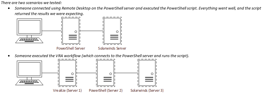

There are two scenarios we tested:
• Someone connected using Remote Desktop on the PowerShell server and executed the PowerShell script. Everything went well, and the script returned the results we were expecting.
• Someone executed the VRA workflow (which connects to the PowerShell server and runs the script).
The script fails with the following error:
