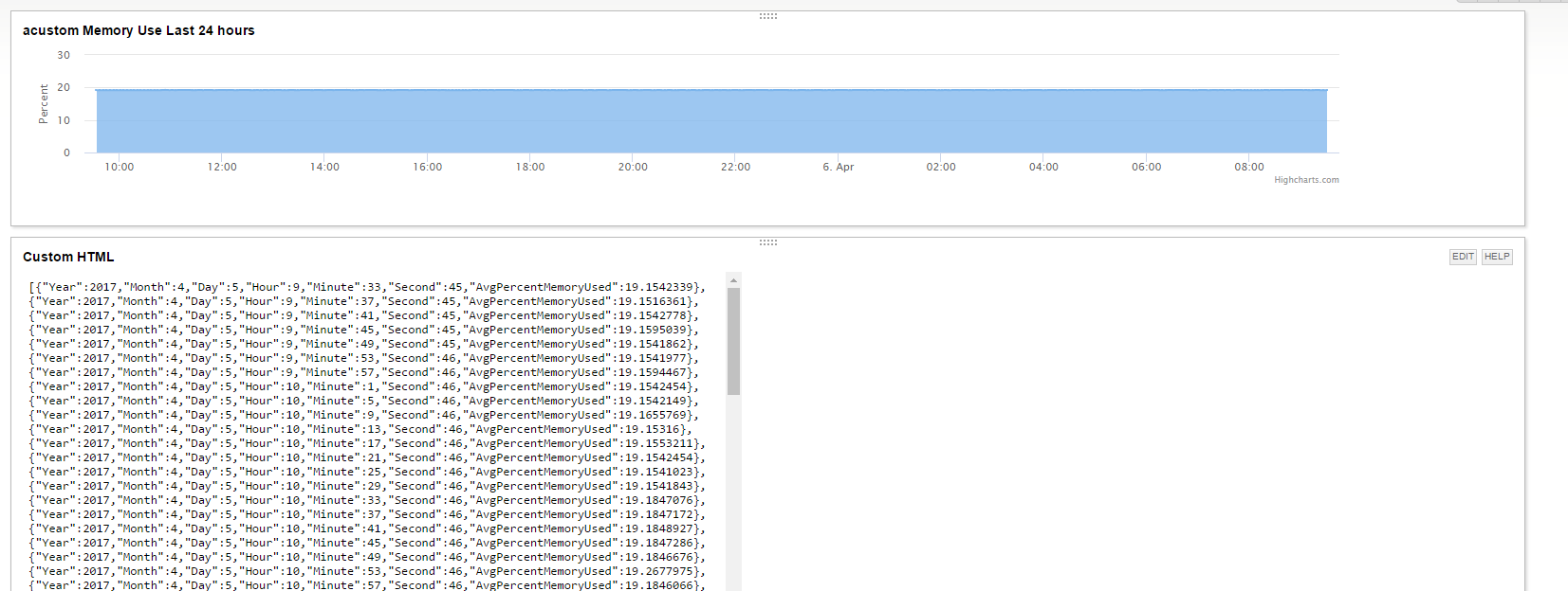

Well, Did It Work?
If all has gone well, and you have made it this far, your work should be now be complete. Or is it? Well, let's do one last step to help us verify all of our hard work has paid off.
So, what are we expecting to see? Well, unfortunately, at this point in the process, we are only expecting to see some boring data in a text file. After you have added the resource to a page, every time that page is loaded, or refreshed, our custom resource should be running through the steps and updating, or rebuilding, our JSON data file. Let's add a simple way to verify the file has the expected data.
To view the contents of the file, simply add the "Custom HTML" resource (the default HTML resource that comes with any standard SolarWinds installation, allowing you to put HTML code directly onto the page), edit that resource, and add the following line of code.
<iframe width="760" height="400" src="/Orion/OrionImprovement/JSON/Mem24Data.txt" frameborder="0" allowfullscreen></iframe>
As long as you have the correct permissions, to view the contents of the folder/file, the contents of the text file should now appear on the page.
Here is a screenshot showing the graph (which we technically have not made yet), as well as the contents of the text file, shown directly under the graph, within the custom HTML resource.
(If you have followed all of the steps to this point, you should actually be seeing a blank custom resource, instead of the graph. We have yet to do any work to create, nor explain, the code to create the graph.)
