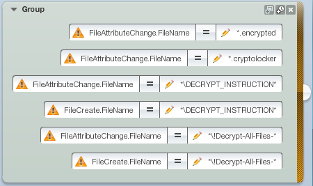

To actually create or edit the alert, you will need to go to the Build > Rules section. Typically you want to clone from a template. Once you are editing your action there are two main parts -- The correlations and the actions. The correlation portion is the most difficult to set up, especially the first time you create one. Typically you want to go back to Explore > nDepth, or possibly look at an event in the Monitor section. You will probably need to come up with a search to try to isolate a relevant event and look at the Event Fields that are important for discerning your desired alert. Once you figure out a relevant event that you want to correlate to an alert, the first and most relevant part is to look at the Event Name as most correlations start with EventName.SubEventField. You can typically swap back and forth between the explore tab and build tab without losing your place, so that's a helpful way to go about it. From the Build > Rule > RuleBuilder screen , you would want to drag an event type from the left menu panel to the correlations section on the right. Typically you want to first select an Event correlating to the EventName mentioned earlier, then select and drag the relevant sub field from below to the correlations tab. The specific parent EventName is important, because if you use the wrong one, your rule might never match, and thus be triggered. On the right side the equals/does not equal and correlation info should be fairly self-explanatory, but keep in mind you can a wildcards (*) or multiple throughout your statement to generate a precise statement (ex: User * has performed * ). Again, you will want to reference an actual event for the structure. Build these with and/or statement chains to narrow down only the specific events you want to trigger your rules. Reference other rules if you need examples.

To send an email as an action, you can clear any other actions from the rule (or leave them if desired), and select Actions / Send Email Message from the right side and drag to the Actions section. You will need to use an Email Template, which is explained how to be created/edited below. The variables from the Email Template need to be linked to either text that will be static/constant (dragged from the constants menu on the left), or from variables derived from the Events/Events Group menu on the left and is used similarly to the way they are used in the Correlation section above. Another reminder that the parent EventName is also very important here when using their child Event Fields. The other part to note is the Recipients, which determines who the email alerts will be going to.
