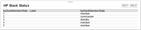

Having 6 or so stacks of Procurve 3800 switches connected using the stacking module and stacking cables, I was finding it hard to get a visual indicator for the Stack status, we have had a few scenarios where one member of the stack goes down, as this is not monitored we were unaware until we went into the CLI.
having just done a Solarwinds Administrator course I was keen to find a way of displaying the information, I found an OID that will tell you the status of stack, details are below.
I was able to turn this into a table in the node view using the universal device poller, just now have to find a way of querying the SQL database to get an alert.
