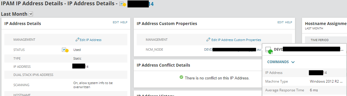

For some reason, there is no integration to link NCM nodes and IPAM records - despite people requesting this for years. The following is my quick solution to this (I want to make this neater, but this was my 30m solution)

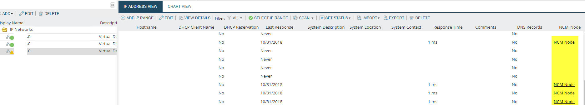

The result of this is a link that appears under custom properties on the IPAM detail screen, and an additional column at the end of the IP Address View list - that has the link text NCM Node (for some reason the link text is not used on the IPAM IP Address details screen)

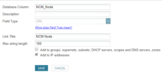

1. Add custom IPAM field NCM_Node as shown:

4. Create a Custom HTML element on the IPAM IP Address Details view. This is responsible for converting the plain text value for NCM_NODE into a working link. Set it to Synchronous load, and put the following code in it:
<script id="custom-script-NodeLink">
$NodeFind= $( "div[sw-widget-defaulttitle='IP Address Custom Properties'] > div > table > tbody > tr > td[class='Property'] > span[columnname='NCM_Node']" )
$linkSplit = $NodeFind[0].innerText.split("|")
if ($linkSplit.length > 1) {
$linkText = $linkSplit[0];
$linkHref = $linkSplit[1]
}else{
$linkText = "Link";
$linkHref = $linkSplit[0];
$NodeFind[0].innerHTML = "<a href='" + $linkHref + "'>" + $linkText + "</a>";
//hide this Custom HTML - optional
//document.getElementById('custom-script-NodeLink').parentNode.parentNode.parentNode.parentNode.style.visibility="hidden"
</script>
If you want all visible trace of the Custom HTML element to disappear after the code has run, un-comment the last line of Javascript.
