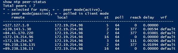

Output
I have added the (working) code to a template we have for sending emails. When the job completes, Write-Host $output presents to the debug window nicely formatted text.

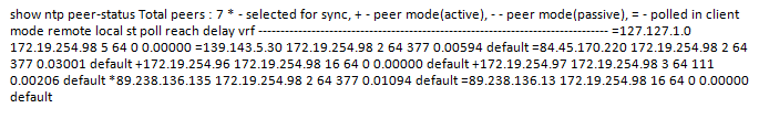

If however I send $output to the email, the text just becomes a single continuous string:
I've tried ConvertTo-HTML:
$($output | ConvertTo-Html -fragment | out-string)
which produces the completely non-helpful:
Now, in all honesty, I'm nowhere near a PowerShell expert, so I'd be gratful for any pointers on what I am (clearly) doing wrong that is stopping the text being a nicely formatted table
