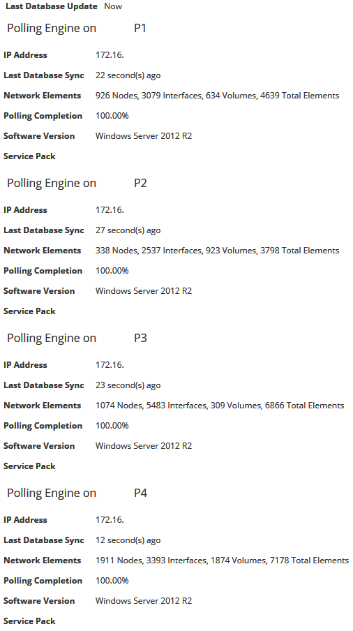

Total Elements (Nodes /Interfaces/ Volumes) been polled per server
Go to folder "DB" > Open file "AllEngines.csv"
Check how many Elements you are polling per server
EngineID | Elements | Nodes | Interfaces | Volumes |
1 | 15828 | 934 | 6823 | 1071 |
2 | 16084 | 202 | 1305 | 77 |
With only SolarWinds SLX license you can montior up to 12000 Elements and beyond this you will need an Additional Polling Engine to monitor.
More Details see the Server Sizing guide .
Server Sizing recommendations
Use additional polling engines for 12,000 or more monitored elements
If you plan to monitor 12,000 or more elements, SolarWinds recommends that you install additional polling engines on separate servers to help distribute the work load.
