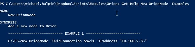

- It’s more intuitive, and fits conventional PowerShell Verb-Noun naming conventions. Plus, the documentation is built-in, so calling the Get-Help command can return help and examples, the same as standard Cmdlets.

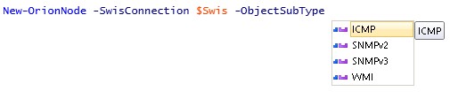

- By building in error handling, and through the use of defaults and parameter sets, there is less chance for user error. For example, when building statements in either the console or the IDE it can prompt on possible options for parameters.
