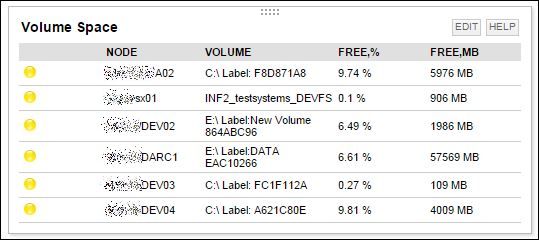

Final result:

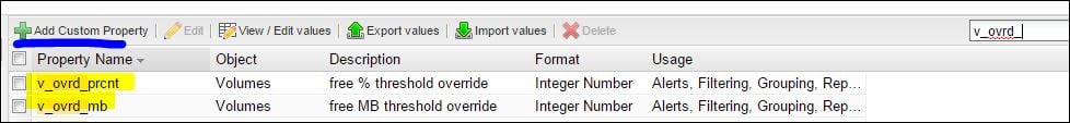

Create two custom properties for your Volumes to override global thresholds on a per disk bases if needed
SETTINGS > MANAGE CUSTOM PROPERTIES > ADD CUSTOM PROPERTY

Use attached report, save it to your Report Writer and add this as a new resource to your summary page via "Orion Report Writer" resource
SQL query used in the report is below:
/* ============================================Author: Alex SoulDate: 23/03/2015Description: Volumes with High Space UsageVersion: Version | Comments | Date | Author 1.0 | for Thwack forum | 23/03/15 | AS--============================================ */SELECT Nodes.NodeID ,Volumes.VolumeID ,'warning.gif' AS 'ICON' ,Nodes.Caption AS 'NODE' --/Orion/View.aspx?View=NodeDetails&NetObject=N:${NodeID} ,Volumes.Caption AS 'VOLUME' --/Orion/View.aspx?View=VolumeDetails&NetObject=V:${VolumeID} ,CONVERT(NVARCHAR(50), ROUND(100-Volumes.VolumePercentUsed,2)) + ' %' AS 'FREE,%' ,CONVERT(NVARCHAR(50), ROUND(Volumes.VolumeSpaceAvailable/1024/1024,0)) + ' MB' AS 'FREE,MB'FROM SolarWinds.dbo.Volumes WITH(NOLOCK)---------------------------------------------INNER JOIN SolarWinds.dbo.Nodes WITH(NOLOCK) ON Nodes.NodeID = Volumes.NodeIDINNER JOIN SolarWindsAux.dbo.CustomVariables cv_mb WITH(NOLOCK) ON cv_mb.Name = 'DiskWarn_FreeMB'INNER JOIN SolarWinds.dbo.Settings s WITH(NOLOCK) ON s.SettingID = 'NetPerfMon-DiskSpace-Warning'---------------------------------------------WHERE Nodes.Status IN ('1','3') AND -- Node is (1)Up or (3)Warning Nodes.UnManaged = 0 AND Volumes.VolumeType = 'Fixed Disk' AND ( ( --free space has dropped below configured thresholds ((Volumes.VolumeSpaceAvailable/1024/1024) < cv_mb.ValueNumeric) AND (Volumes.VolumePercentUsed > s.CurrentValue) AND (Volumes.v_ovrd_mb IS NULL) AND (Volumes.v_ovrd_prcnt IS NULL) ) OR ( --or free space has dropped below BYTES override (if custom PERCENT override has not been set) (Volumes.v_ovrd_prcnt IS NULL) AND (Volumes.v_ovrd_mb IS NOT NULL) AND ((Volumes.VolumeSpaceAvailable/1024/1024) < Volumes.v_ovrd_mb) ) OR ( --or free space has dropped below PERCENT override (if custom BYTES override has not been set) (Volumes.v_ovrd_prcnt IS NOT NULL) AND (Volumes.v_ovrd_mb IS NULL) AND (Volumes.VolumePercentUsed > (100 - Volumes.v_ovrd_prcnt)) ) OR ( --or free space has dropped below both PERCENT and BYTES values for custom set overrides (Volumes.v_ovrd_mb IS NOT NULL) AND (Volumes.v_ovrd_prcnt IS NOT NULL) AND ((Volumes.VolumeSpaceAvailable/1024/1024) < Volumes.v_ovrd_mb) AND (Volumes.VolumePercentUsed > (100 - Volumes.v_ovrd_prcnt)) ) )Future improvements:
