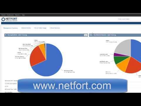

So the next questions is, does it impact in you. If you use any online secure service then you can use this tool to check if the service is vulnerable. The next issue you may have is if systems on your network are running OpenSSL. The critical ones would be public facing web services. These would need to be checked and updated to OpenSSL 1.0.1g. You should also check if any other systems are running OpenSSL on your network. Anything from NAS systems to management tools can be using OpenSSL. Also, don't assume that the service will be running on TCP port 443. This can be changed. I put together the short video below which shows one method to check for the presence of SSL/TLS servers on a network using packet analysis.
