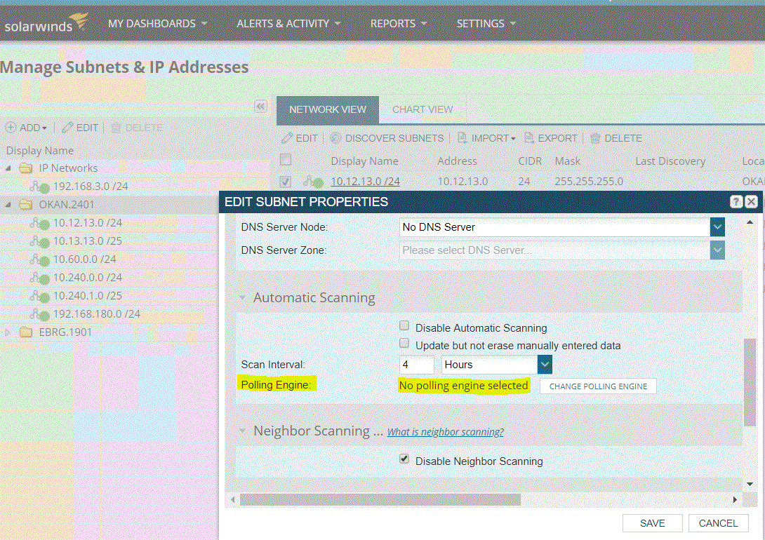

I am at my wits end, I'm trying to automatic some internal business workflows;
Using Orionsdk-python, I am creating subnets. While creating these subnets I notice in IPAM that the 'Automatic Scanning' 'Polling Engine' is not set.
Example:
My python 'meat' to create this subnets are as follows;

As you can see in the picture, the subnet is created,... but the Polling Engine is left blank.. for automatic subnet scanning
So any subnet that I create will not Automatically be scanned,..
How can I specify what polling engine to use?? Any ideas would greatly be welcomed! Thank you ahead of time, and thank you for at least reading this.
