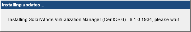

I started a VMAN appliance upgrade from ISO this AM and this is what I've been looking at for 4 hours:
I THINK I've been patient enough, but I'm looking for input.
What can I do from the appliance to see if the upgrade is actually doing anything?
Hi,
in https://VMAN_IP_addr:8450 you can go to "SolarWinds Mgmt -> View Recent Log Activity" menu and choose Log = h9maint.log. There are all info related to the upgrade.
You can also download bundled logs in "SolarWinds Mgmt -> Status" menu and press "Bundle Logs" button. After a while you can download a new GZ file.
If it's not clear from the logs what's going on then contact SolarWinds support and send them the bundled logs.
Also nothing wrong should happen if you stop the upgrade process and run it again.
Does it help?
