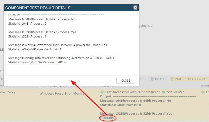

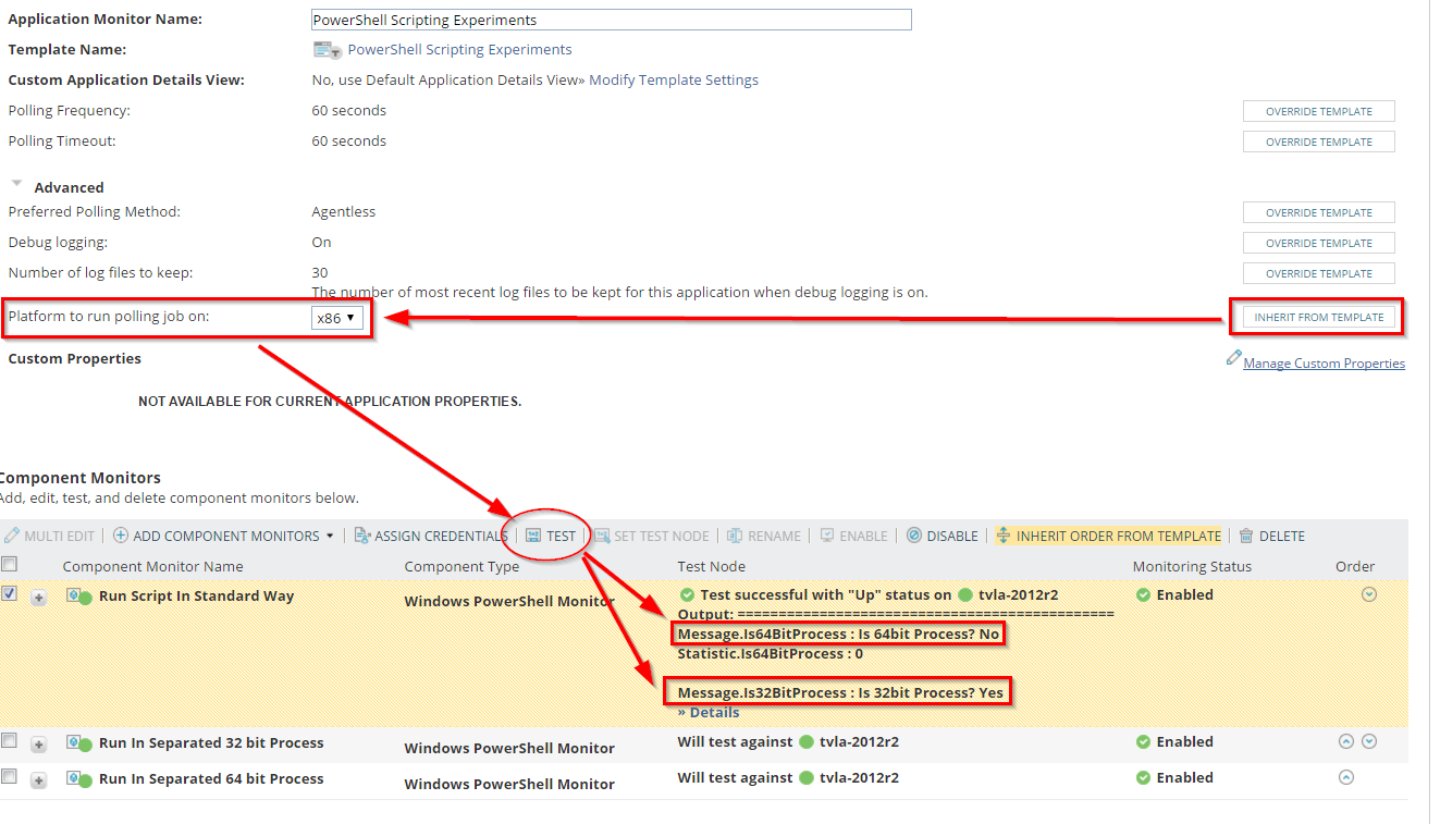

You can try switching execution platform and check resulting bitness of each approach:
You can do your own experiments - switching bitness and Local/Remote host and Agent/Agentless mode, to get a better understanding, what results every approach gives.
