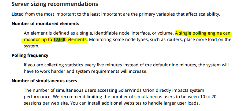

All of us know SolarWinds SLX license you can monitor up to 12000 Elements and beyond this you will need an Additional Polling Engine to monitor.
Use additional polling engines for 12000 or more monitored elements if you plan to monitor 12000 or more elements, Solarwidns recommends that you install additional polling engine on separate server to help distribute the work load.

As you are aware a single poller can tackle upto 12k elements

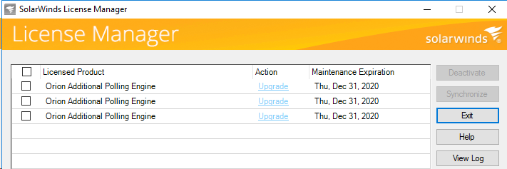

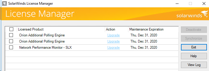

Also after the license has been applied you can open the License Manager and you will see another entry in the Lincense Manager as following
On Primary Polling Engine it will take up to 2 MAX Additional Polling Engine license keys
On Additional Polling Engine it will looks like this
You will have the message "The machine has reached to license limit" after that therefor it will only be able to take up to 3 licenses.

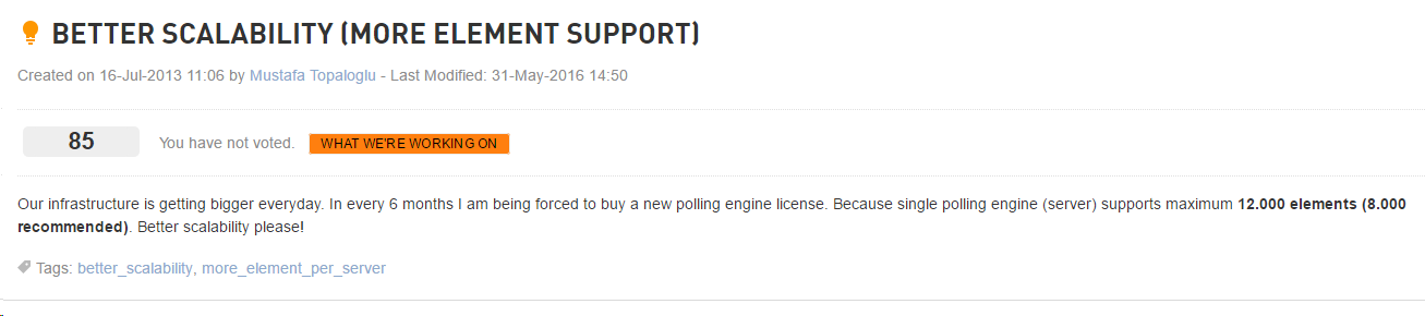

I have SLX Licenses why i still need the Additional Polling Engine license ?
The SLX license is based on throughput, not elements. This is a completely different type of license than our element tiers.
The NPM SL100 license is based on elements. The NPM SL100 is a hard limit of nodes, interfaces, and volumes. You can modify the polling intervals, but you cannot exceed 100 nodes, interfaces, and volumes.

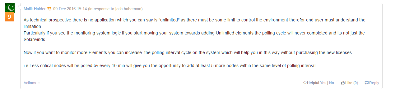

With an NPM SLX most customers can manage about 12,000 elements at default polling intervals today. Many customers modify polling intervals and can manage many more elements because we do not cap the number of elements.
Our development team made multiple performance improvements and increased the throughput a SLX license and APE can poll. Over the last 5 years we’ve increased the throughput so that at default polling intervals a customer could go from monitoring 8,000 elements to 10,000 and now to around 12,000 elements. While I can’t commit to increasing this again in the future, we have a consistent track record of doing so.
Why this often gets over simplified to “SLX == unlimited”. For the vast majority of customers who purchase an SLX, the difference doesn’t matter because they are happy with the default polling intervals and don’t have near enough elements to run in to the throughput restriction.
