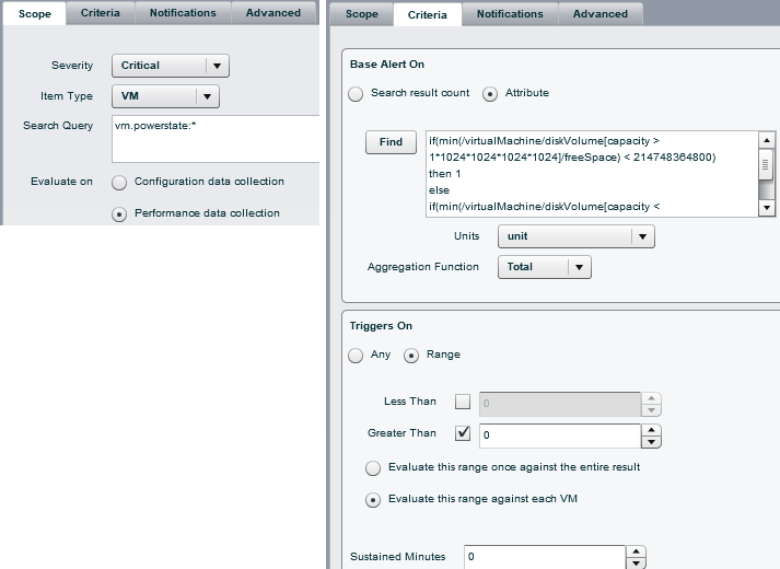

I am using this currently :
if(/virtualMachine[./name="xxxx"]/diskVolume[./mountPoint="E:\"])
then 100
then 100
then 100
else /virtualMachine/diskVolume/freeSpacePercentage

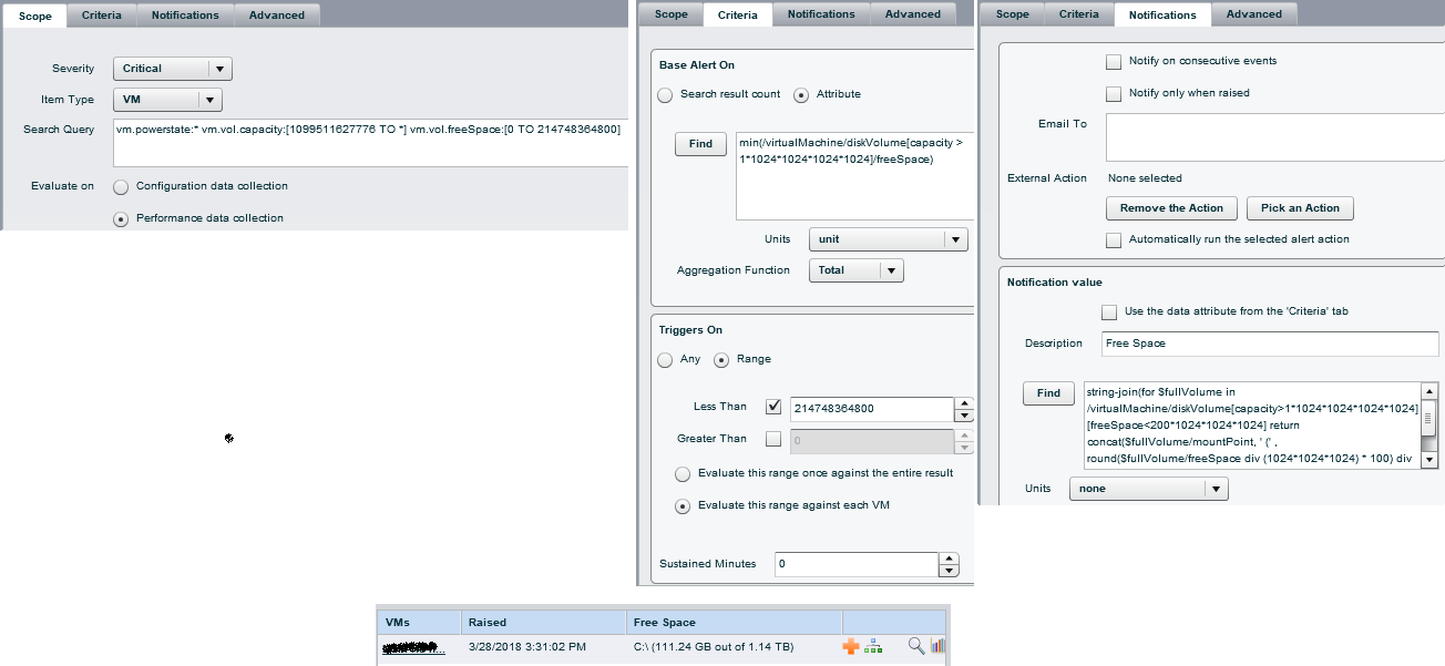

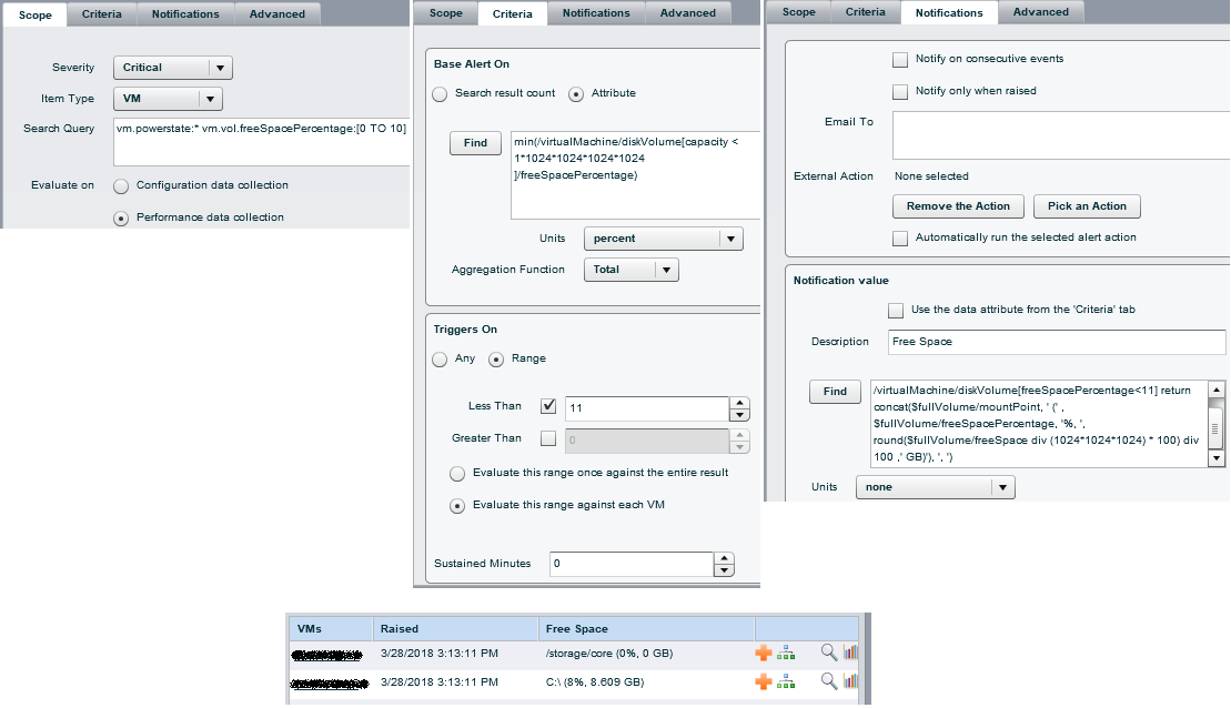

also can you combine an alert to include both % and FreeSpace remaining in the email ? i tried to combine :
string-join(for $fullVolume in
/virtualMachine/diskVolume[freeSpacePercentage<=10] return
concat($fullVolume/mountPoint, " (" ,
$fullVolume/freeSpacePercentage, "%)"),",")
string-join(for $fullVolume in /virtualMachine/diskVolume[freeSpacePercentage<=10] return concat($fullVolume/mountPoint, ' (' , floor($fullVolume/freeSpace div 1024 div 1024 div 1024), 'GB)'), ', ')
in the notification value, but no such luck
