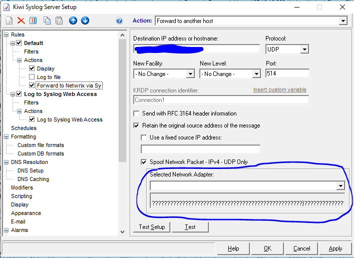

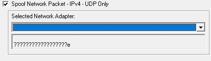

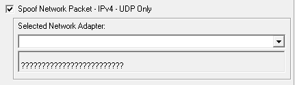

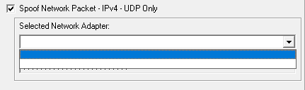

I have a licensed version of Kiwi 9.6 installed on a Windows 2016 Server. I was specifically hoping to use the "Spoof Network Packet" feature to forward packets to a downstream server. The help file says the server needs to be licensed (Done!) and that WinPcap must be installed. The problem is, WinPcap is deprecated for some time now, and not compatible (or at least not suggested) with Windows 2016. I use Npcap, which is the recommended way to go for W2016. I have even installed Npcap with WinPcap compatibility (a requirement of Wireshark) and that works correctly (with Wireshark). Unfortunately, with regards to the Kiwi server, something is still missing. The tick box is now available, but I cannot select a network adapter. Saving this config as is results in no data being sent.
