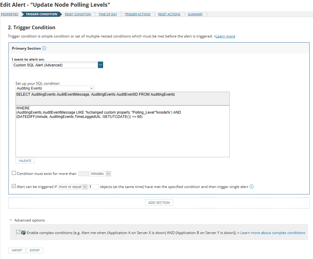

The custom SQL alert:
- Evaluation Frequency of Alert is set to 1 hour (works for us), is Informational and resets after 15 minutes
- Enable complex conditions and set it to trigger if more or equal to 1 objects
- Grab the PowerShell command mentioned in the script, probably a good idea to change the location of the script etc.
- Add a trigger action to Run a Command which executes the PowerShell script (an example of this is in the script)
- The SQL condition:
WHERE
(AuditingEvents.AuditEventMessage LIKE '%changed custom property ''Polling_Level''%node%') AND
(DATEDIFF(minute, AuditingEvents.TimeLoggedUtc, GETUTCDATE()) <= 60)
