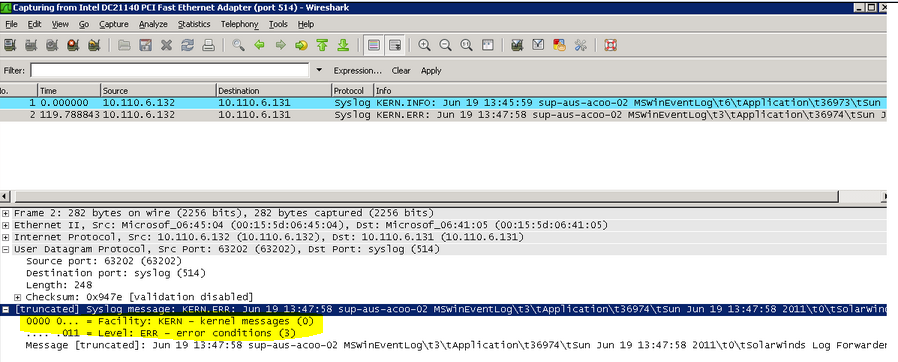

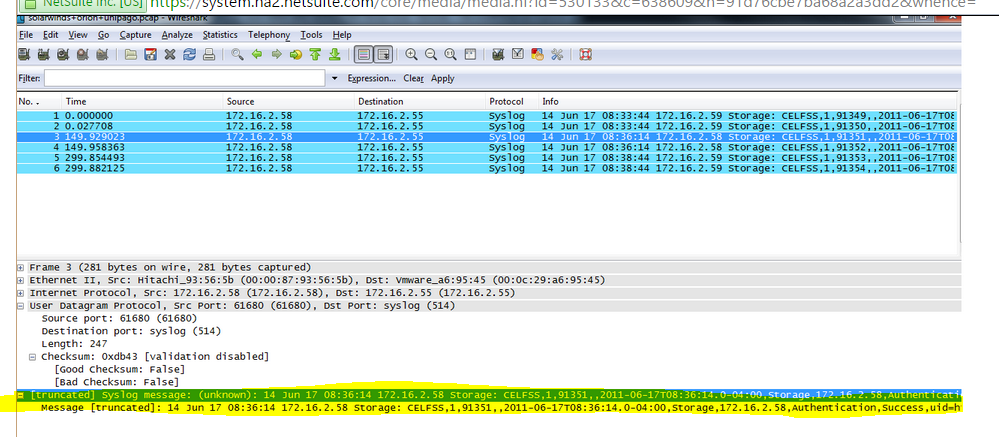

Looking at the packet capture from effected host , Comparing that packet capture to tests that I ran on my lab server, the Syslog messages are not coming across with a severity or facility.
screen-shots of the packet capture from effected node , notice the (Unknown) part on the Syslog message in your packet capture and then looking at my test capture that is were the facility and severity should be.
