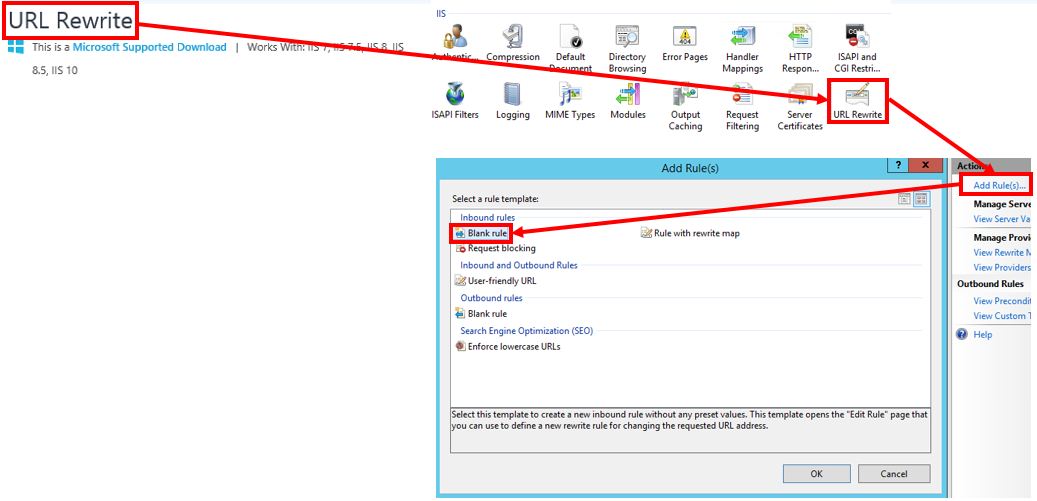

2) http to https redirection using URL Rewrite
a) install URL rewrite for IIS and add a rule for redirection.
b) Configure rule
