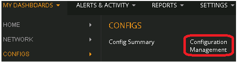

Step 1. Navigate to the Solarwinds website and hover over 'My Dashboards'
Step 2. Hover over 'Configs' and select the 'Configuration Management' option.

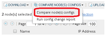

Step 4. Select 'Compare Node(s) Configs' and then select 'Compare Node(s) Configs' again. Once you make this selection Solarwinds will compare the configs for you based on the date of the config you select.
