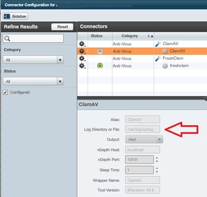

The default connector setup for the Linux C-L-A-M AV monitors the /var/log/messages file. Ubuntu got rid of the messages file in Ubuntu Version 11.04 and replaced it with /var/log/syslog.

Once your device is imported into the LEM Console you will need to change the default LEM clamav and freshclam connector to /var/log/syslog

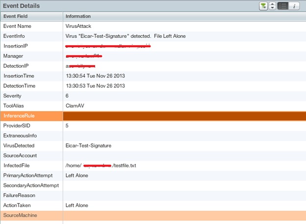

clamscan --stdout --no-summary --log=/var/log/clamscan.log -i -r /home | logger -t "clamd[5286]"
The resulting virus detection event is logged into the Syslog, Imported into LEM, and the resulting event looks like this:
