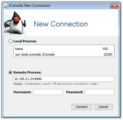

Choose Remote Process and enter the IP:Port and click connect.

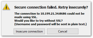

Since we originally set the jmxremote.ssl=false we'll get this message, just continue anyways by clicking Insecure connection.

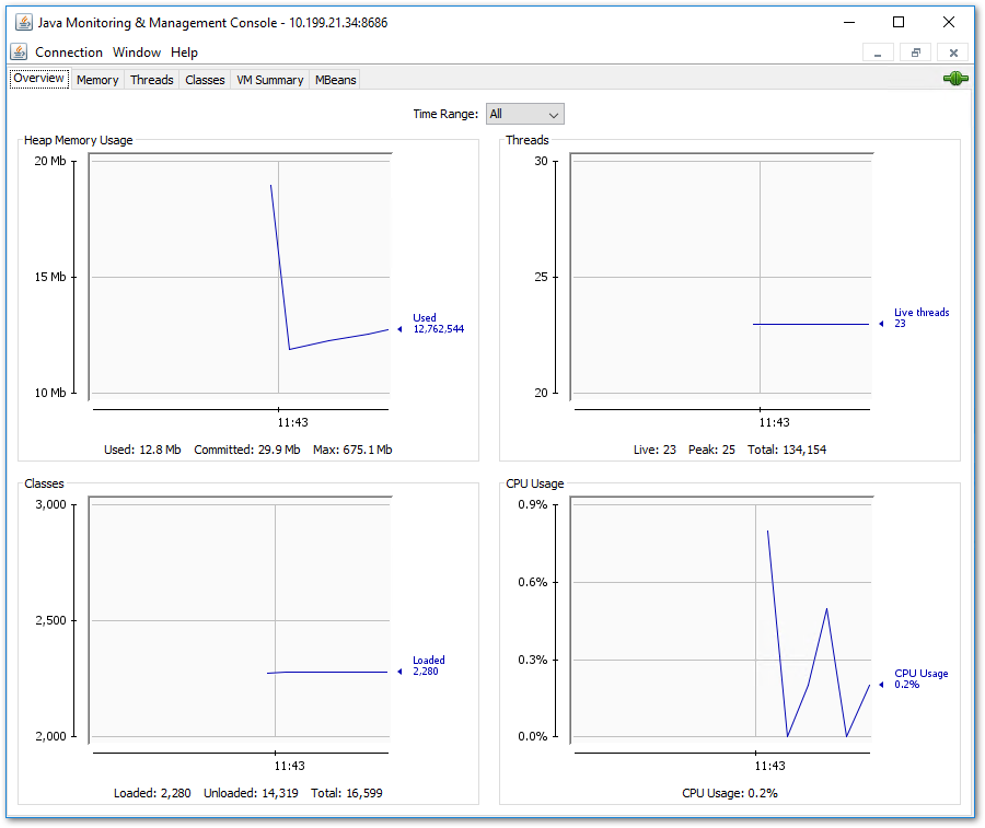

Success
If all of your hard work has paid off you should be presented with this screen.

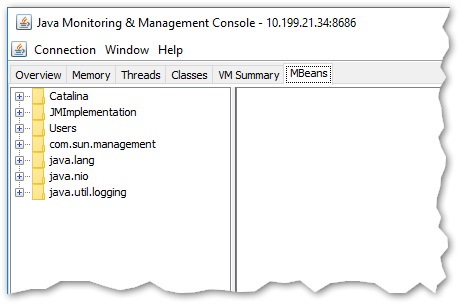

The MBeans tab is where all of the details of the application are located and it's what SAM is polling metrics from. We'll dive into this a little more in another article.
