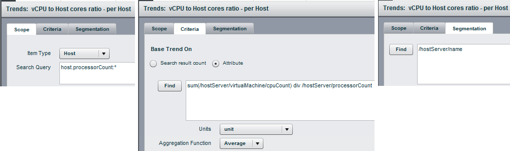

I found the trend for cluster level vCPU to pCPU ratio, but I'd like to see it broken down to the host level is this possible with virtual manager?
thanks,jb
Hi,
yes, it's possible to create a new Trend that shows vCPU to pCPU ratio for Hosts. You can create a copy of existing "vCPU to Host cores ratio" trend and configure it to your needs, i.e.:

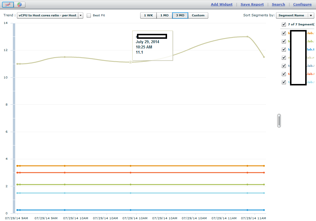

Then the trend lines should look like this:
Note: as this is a new trend, there's no historical data available. The trend process is executed automatically every 4 hours by default. It's recommended that the four hour period remains unchanged but if necessary it can be modified in Setup - Administration - Advanced Setup - System Properties -> "Hourly Interval for Trend Execution" property. You can also launch the trend process manually in Setup - Administration - Advanced Setup - System Maintenance -> Run Trends.
Does this trend suit your needs?
